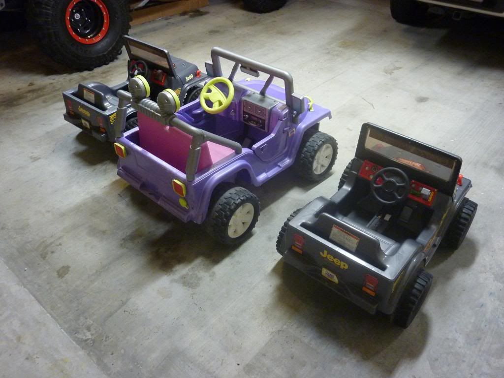

The evening I picked them up.
Parked next to the Barbie Jammin Jeep that I planned on modding at the time.

So, who put the sticker on upside down?
You'll want to hit the For Sale forum and get an extra 3A gearbox and motor to convert it two 2WD - so it won't get stuck in the grass.

I wish I could have been the one to put the stickers on. The crooked guages and headlight are driving the OCD side of me crazy.
Yea, my 4 year old neice took it for a spin last night. The 6 volt system is pretty gutless. It could barely push her around in the grass much less enough power to break one of the wheels loose. I definetly see a 12V and 2WD conversion in the future.
I have two of the larger Barbie Jeeps that I am taking apart to make one. I should be able to use the wiring, shifter, and gear boxes from one of them for the conversion. It might be easier to pick up another 3A gear box, but I already have these. The bigger gearboxes will be geared lower than the 3A but I have the larger ~10" tires to go with it. I haven't had a chance to pull the wheels off yet. Are the interlocking hubs of the smaller tires on the Blitz Jeep interchangeable with the larger tires?

Yes, all the Power Wheels use the same wheel driver.
It's not easy putting the #7 gearboxes under the Lil Jeep, but it has been done.
I just put a set of Super6 motors on 3A gearboxes in mine, and it flies!
