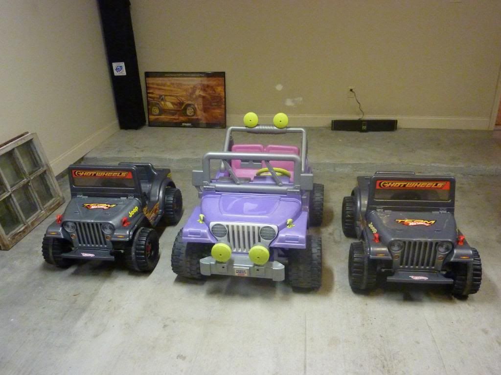

Once the initial anxiety wore off after I found out I was having a son, I started researching what type of motorized toy I would eventually get for him. It didn’t take me long to find this site, and it all went downhill from there. I knew I was going to repaint whatever I got my hands on so my only requirement was a Jeep with black tires. After scouring CL for months and telling friends about my future plans, one my buddies recalled a Power Wheels that his niece and nephew had out grown and was sitting outside because of a dead battery. He said it was initially for a girl, so I figured it was your typical sun faded Barbie Jeep that I have seen restored on this site. I was very excited to find out it was a Barbie Jammin Jeep in great condition, visually.
Like most children’s toys, it was abused, overloaded, rode hard, and put up wet. I think the only reason the tires have any plastic left is because it was mostly used in the grass. There are many small things that separate this Power Wheels from a brand new unit, but in the world of “Free Toys” this thing is pristine. The camber is way off on the front tires. The tierod was broken and patched back together. The front end is toed out pretty bad. The windshield frame and supports are barely hanging on to the body. The front fog light support is broken. The body is almost camouflaged by white streaks as evidence of the plastic unibody being over stressed due to who knows what. All easily over come with a little elbow grease and ingenuity.
The reason I wanted to modify a Jeep: I have owned my 92 Wrangler for over 10 years and don’t plan on getting rid of it any time soon. I am looking forward to the day when my son is big enough for me to take him on trail rides (wheeling) and camping. For the time being, I am going to try to build a smaller replica of my rig that has evolved over the years. The plan is to cover up any of the pink, purple, or yellow; add simulated beadlock wheels/rings, LED head/fog lights, aftermarket battery(s), and if I can track them down, a lift and 4 eliminator rear tires. My Jeep has Swampers and the eliminator tires are the best replica of that I have seen. I don’t plan on modifying the electronics or drive train too much, mostly aesthetics for now.
Today my son is 12 weeks old, so he won’t be driving this one for a while. Yea, I know. Once I got the bug I couldn’t wait two years to start a project like this. I recently bought myself some extra time to work out a few more details before I start the complete tear down. I’ll explain the “extra time” later. For now I will just share a few photos of his new rig(s) before I get too deep into the build.
Without him knowing, I do have to give credit to the guy who gave me the bug to start this project. Artax and his Project Barbie Jeep Makeover (Man up!!). They say that imitation is the most sincere form of flattery. I hope to not insult his work as I try to somewhat duplicate it. I will try to document my build but I have been known to get lost in the work and forget I have a camera.
I have don’t quite a bit of searching and reading on this site, but I am sure that I will still have a few questions along the way. If you can give me an additional details about the Barbie Jammin Jeep I would appreciate it.

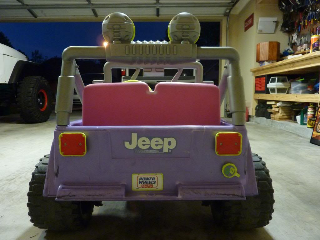

So…On with the pics.

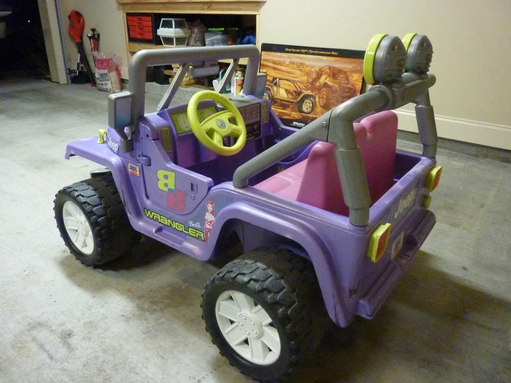

The first picture I received. I was pretty pumped to find out what it was.

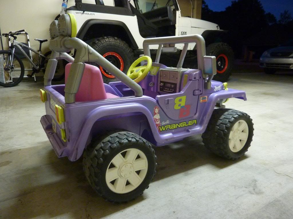

The night I picked it up.
I couldnt wait to take pictures in the daylight so I snapped a few before I went to work the next morning.

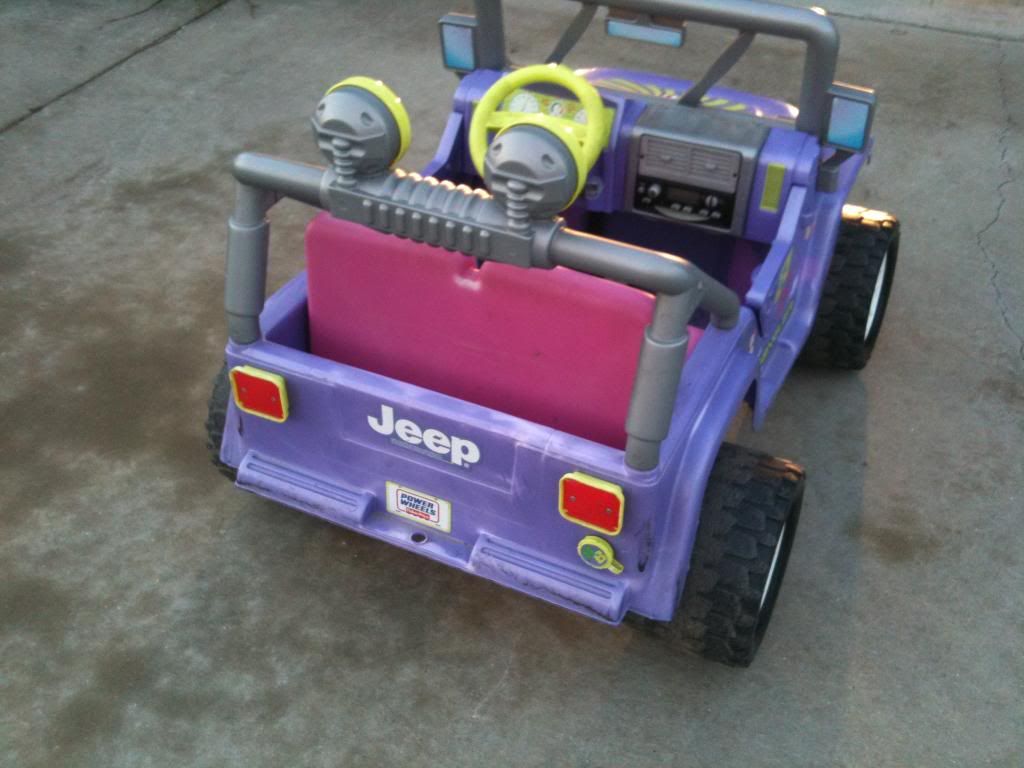

And this is what I meant by "extra time". While searching CL for other Power Wheels that I can scavenge parts off of, I ran across a deal that I couldn't pass up. I bought these two pristine Jeeps for $80, both running with chargers. Since these are running, dont need any desissifying, and are bitter fit for smaller kids, I have more time to work on the bigger Jeep as he grows out of the Blitz Hot Wheels Jeep. The plan is to give the extra one to a friend's little boy that was born around the same time as my son. I will start another thread on these.

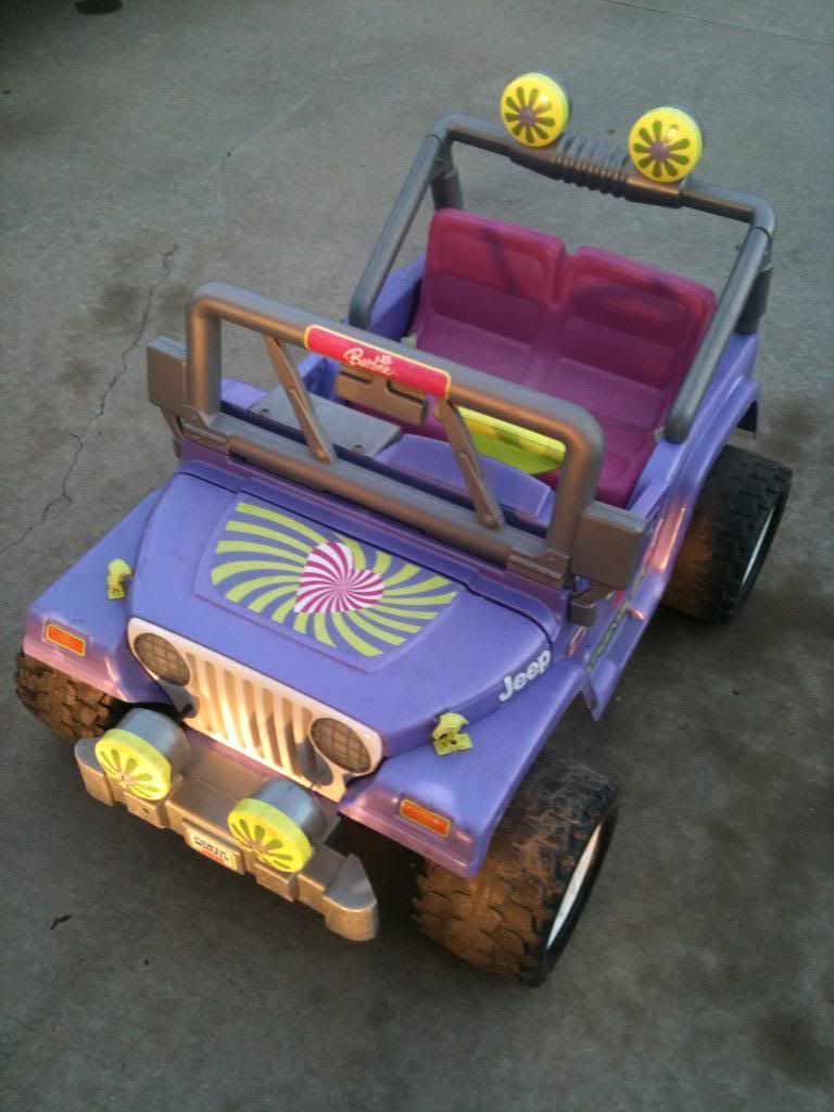

This is a preview of how the Barbie Jammin Jeep currently sits. I need to nip this problem in the bud before it gets out of hand.

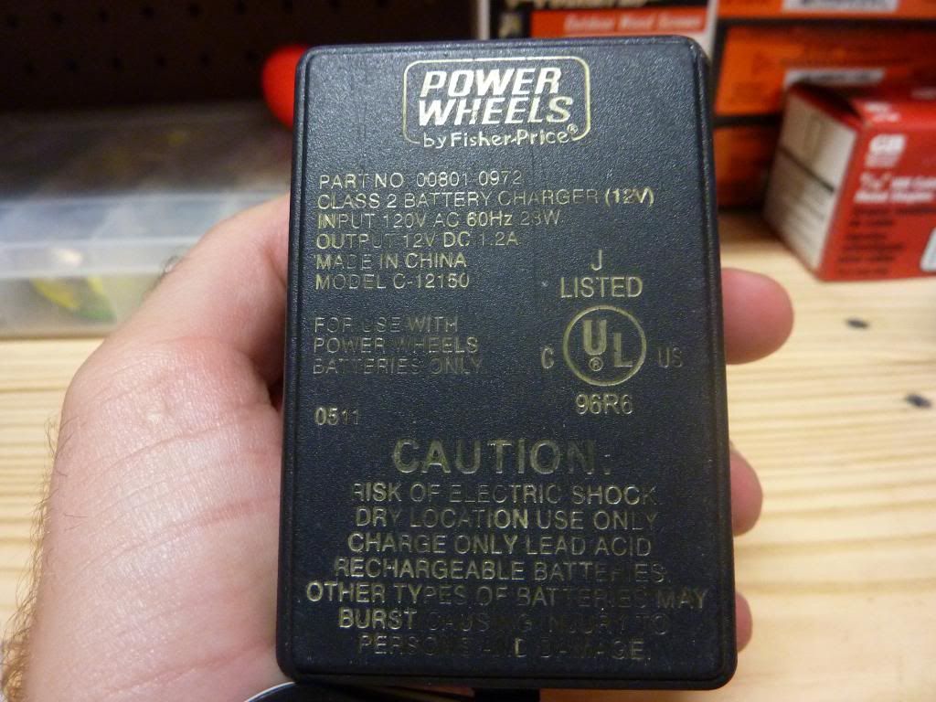

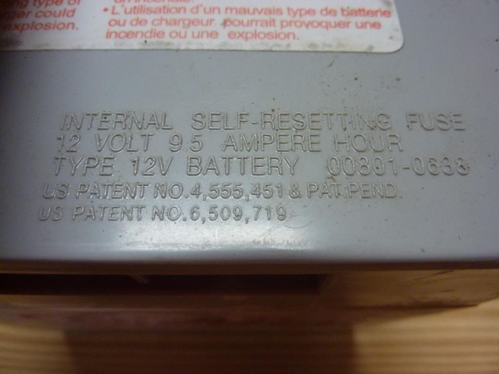

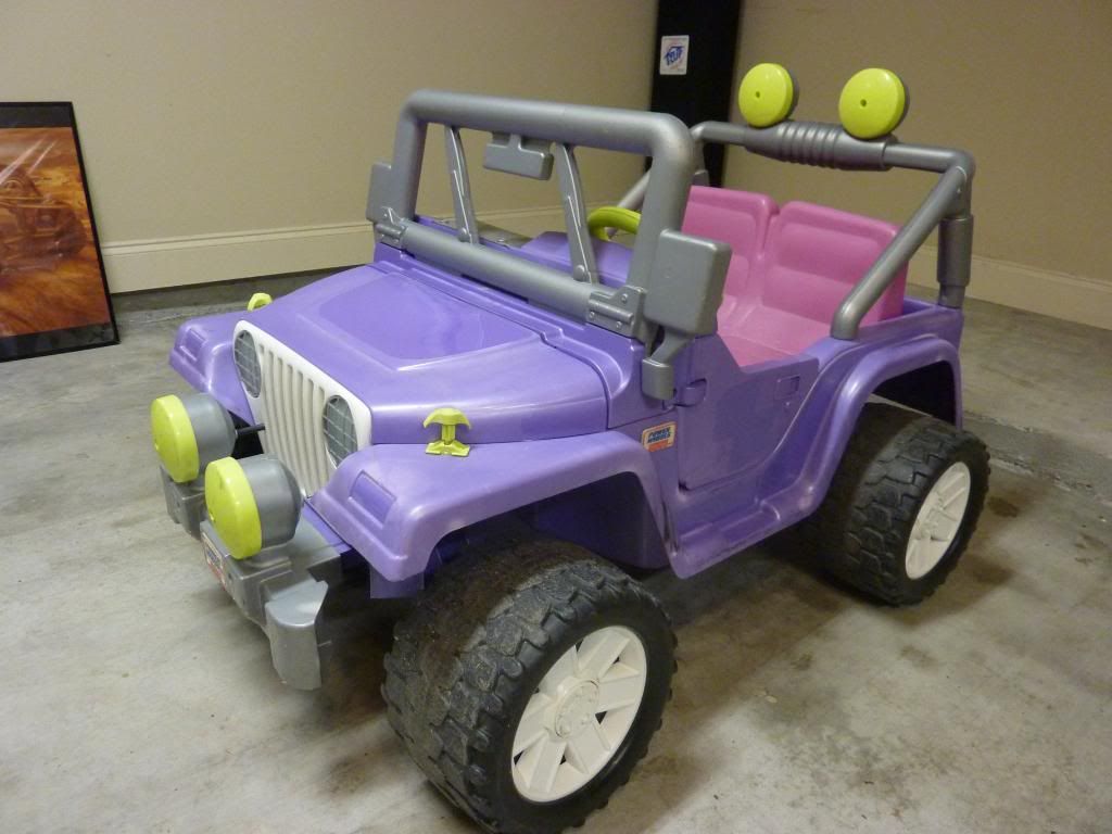

Here are a few more detailed pictures of the Barbie Jammin Jeep.
It wasn't that dirty but a little cleaning did wonders.

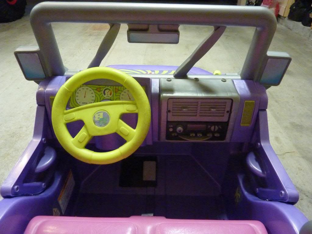

The LCD display doesn't work and neither does the FM radio, but the standard Barbie pep talk plays when you push in the "CD".
Model Number Tag
Battery Compartment

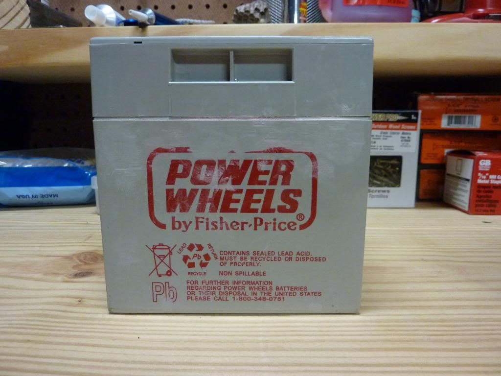

Stock Battery Info
The battery is showing 3V on the ole voltmeter but when the throttle switch is pressed, nothing happens. I plugged the charger in and I get 0Vs. That means the charger is fried. I will try to locate a new/used one and see if they old battery has any life left.

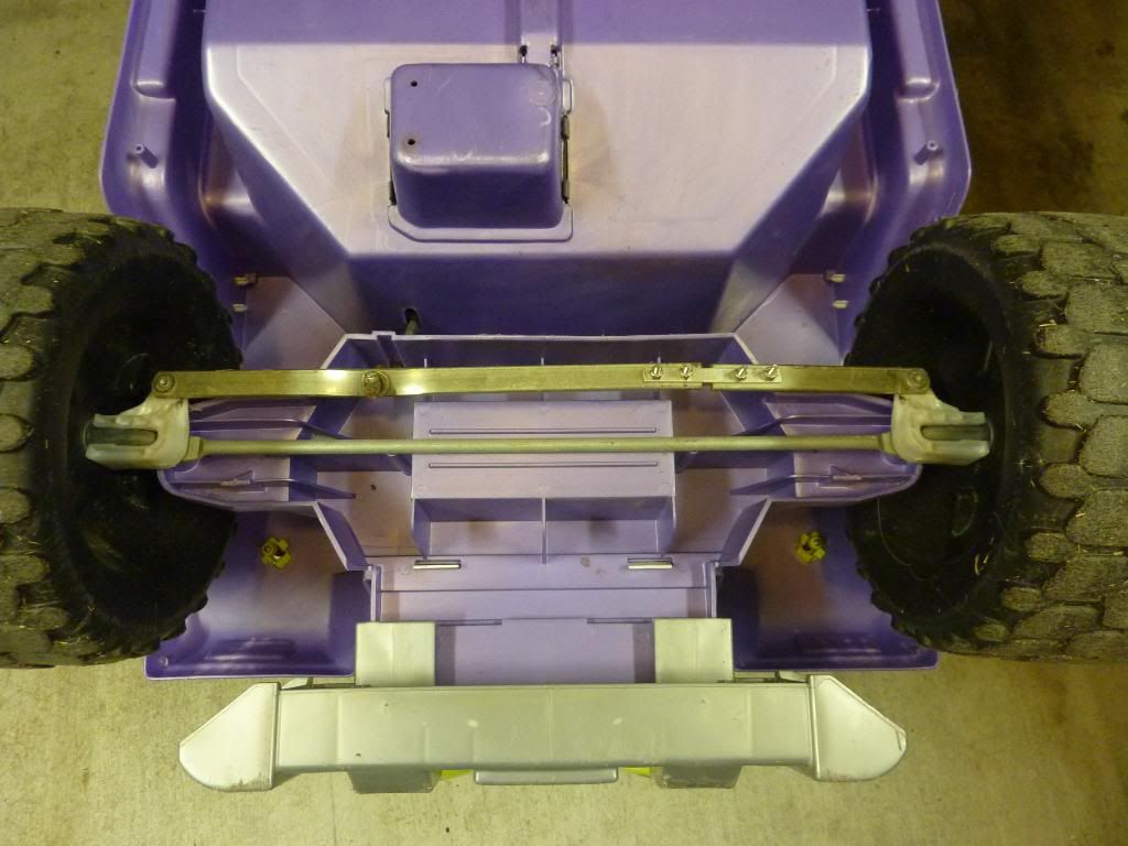

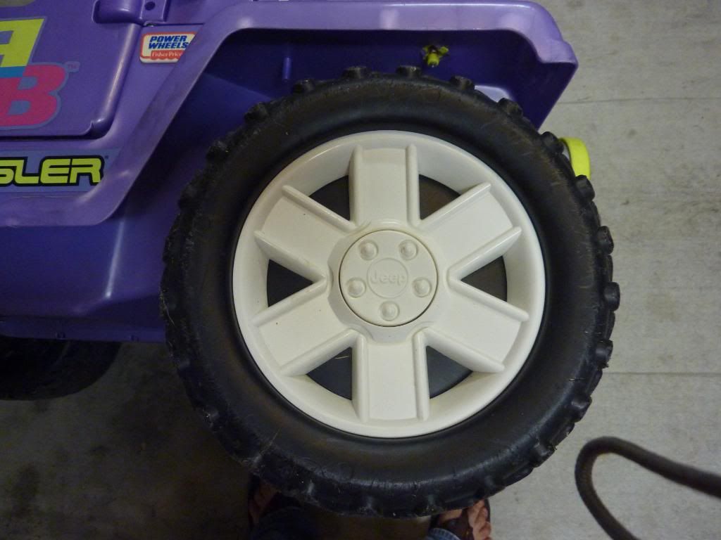

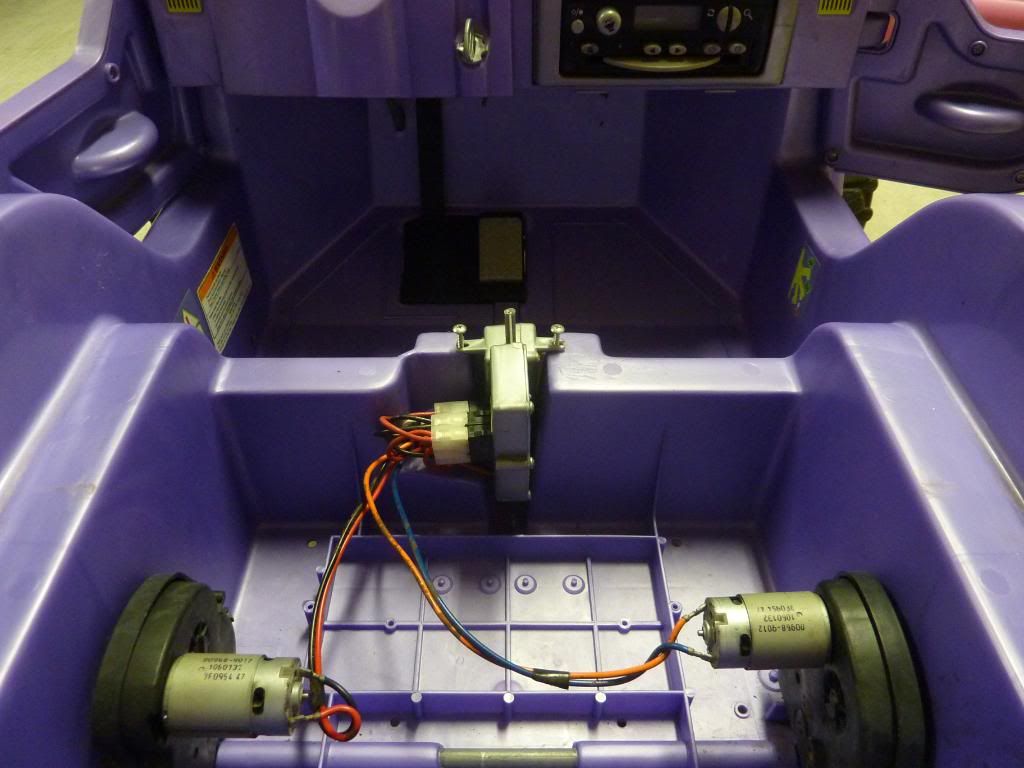

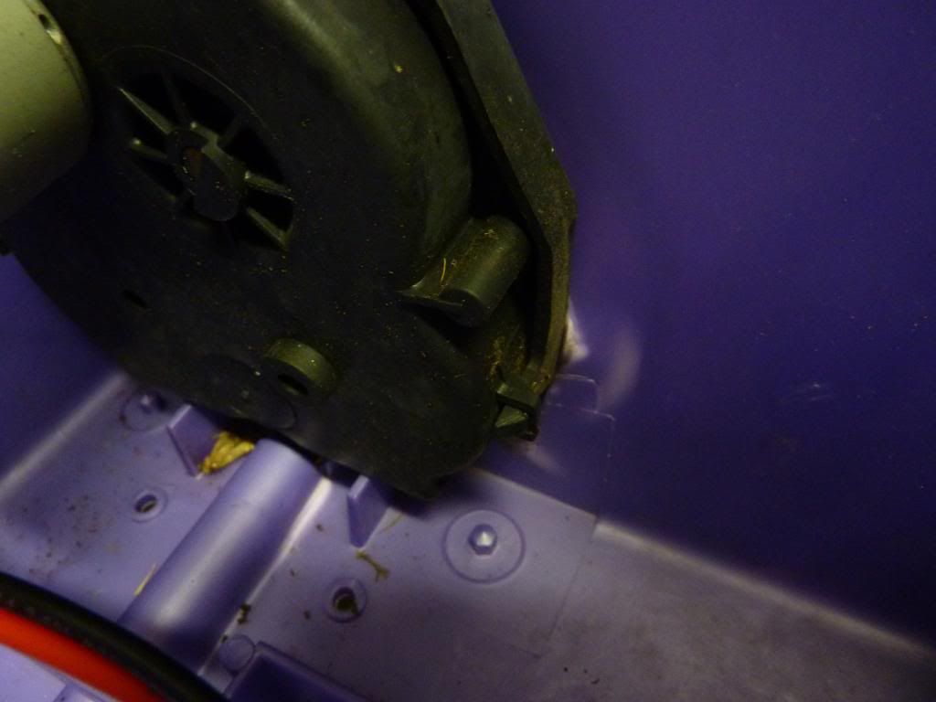

Here are a few photos of the steering and drive train.
See any thing abnormal.
These kids are rough I tell you.

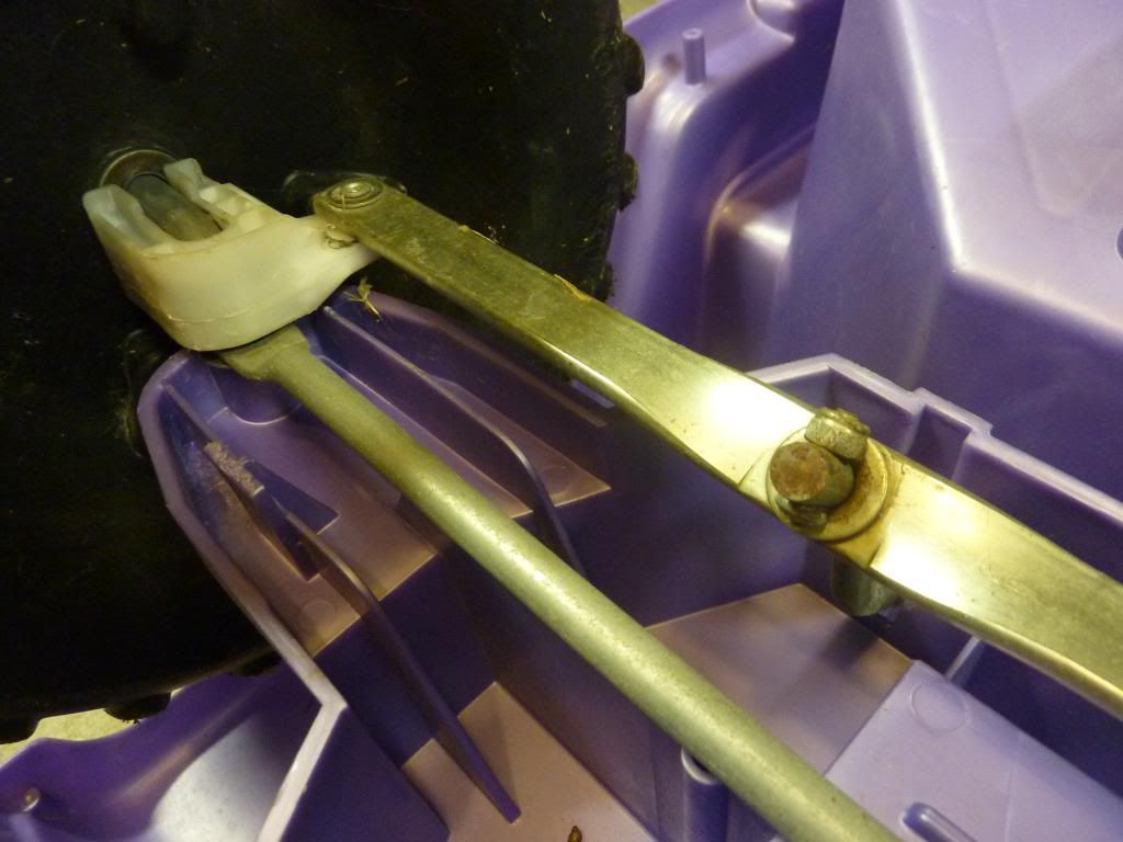

The steering stops are a little busted up. Shouldn't be too bad after a little overhaul. Is the screw and nylock on the steering shaft a factory piece or was this added by the previous owner?

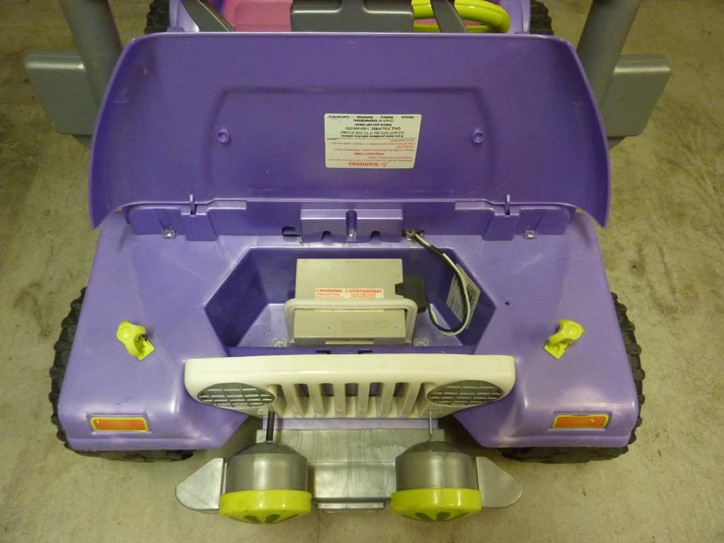

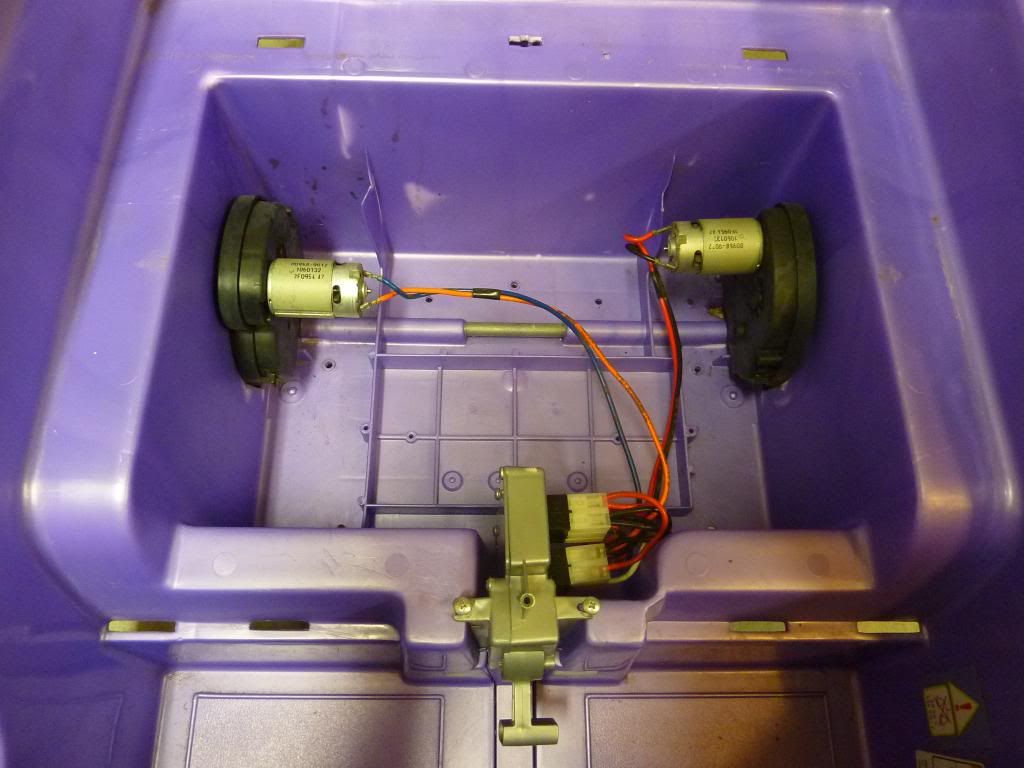

Gear boxes and motors
You can see some whitening of the plastic due to over stressing.

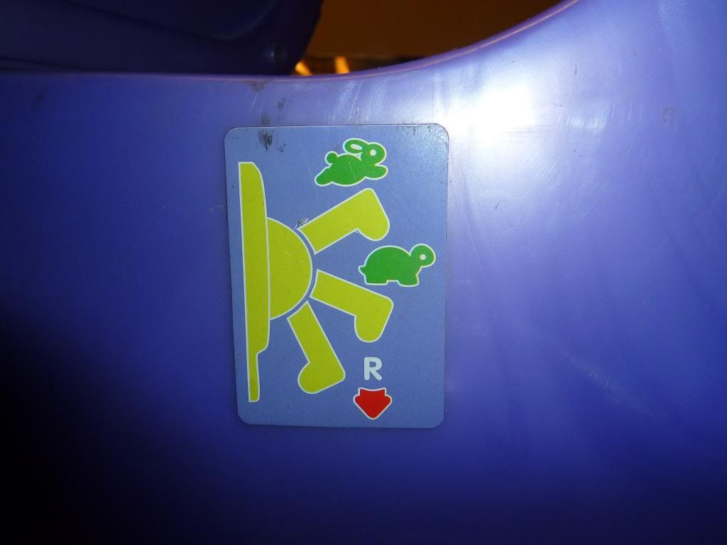

Shifter positions.

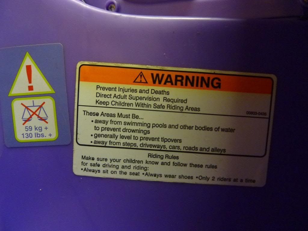

Weight limits and warnings.

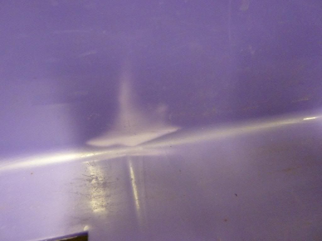

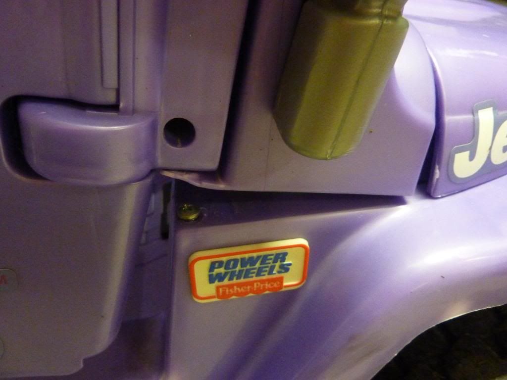

Here are a few shots of the current damage to the body. Nothing that cant be overcome.

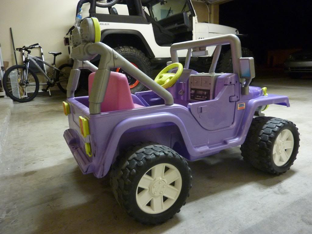

And this is how she sits right now. I read some great sticker removal advice this forum. I picked up a $20 1000W heat gun and it made incredible easy work of removing the stickers. They were just chipping off before and after a little heat the whole thing pulled right off and didn't leave any residue. That $20 was well spent.

Posted - 11/24/2010 :  15:57:32  Show Profile
The bolt with the teflon lock nut on the lower end of the steering shaft is oem equipment.

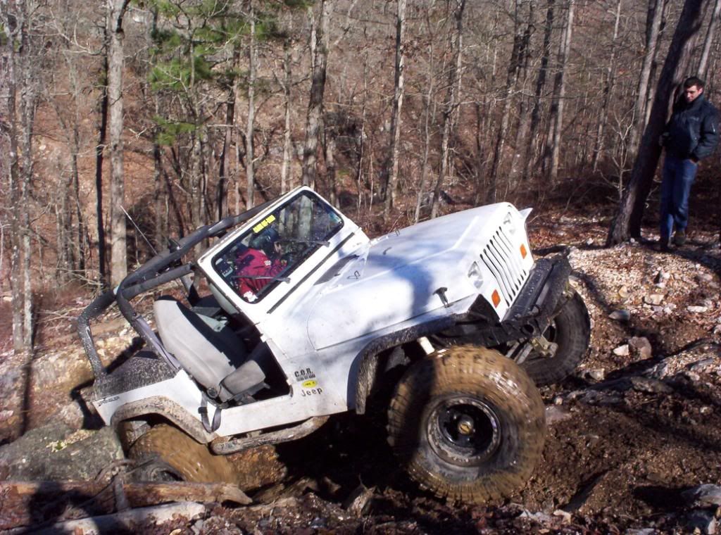

I dont have any recent pictures of my YJ, but for those of you that care, here are a few.
92YJ/2.5L/HD4:1D300/F&R D44/5:38/36"SX/99"WB
Most of these are from the Superlift ORV Park in Hot Springs, AR.
I'll have to grab a more recent driveway shot.

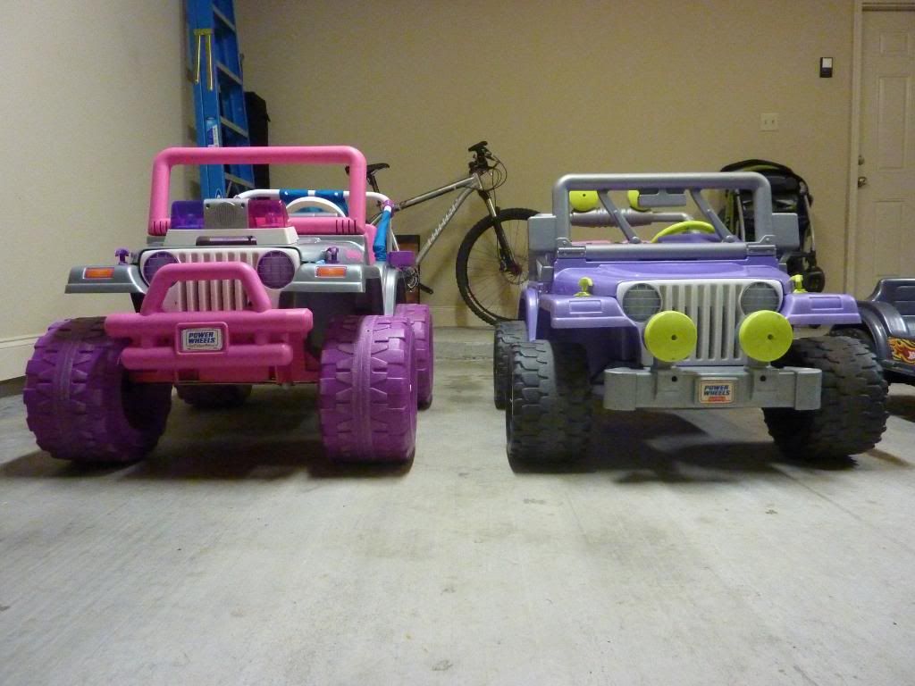

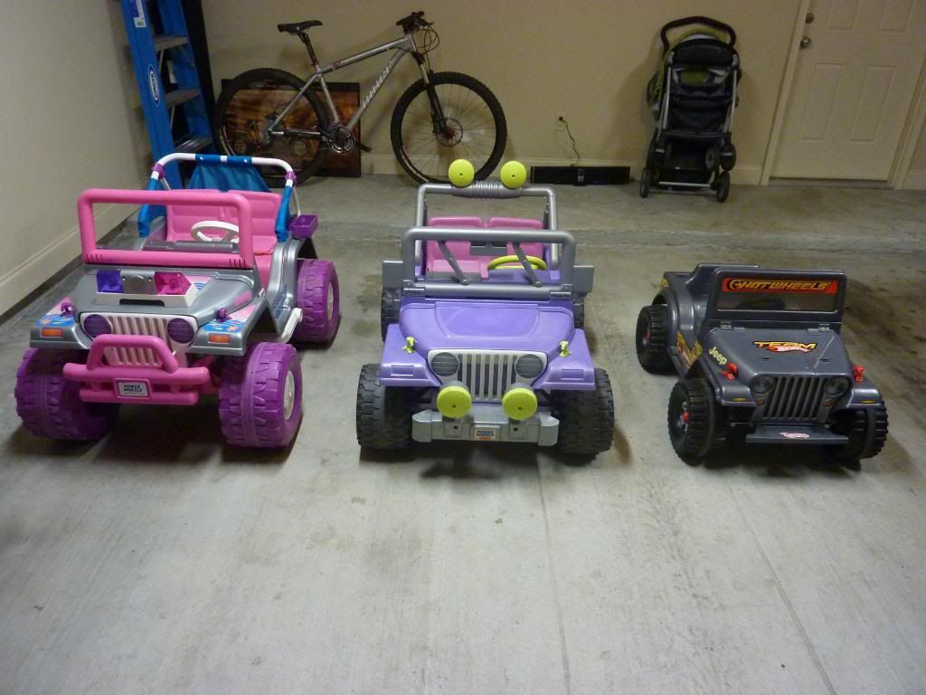

I was just looking for an cheap PW Jeep to scavenge parts from and I ran across this jewel. The stars aligned and now I have more than just a few parts.
Beach Ranger Jeep (now de-stickered)
Working charger (1st), battery doesn't hold a charge, and it was never shifted into high gear because the guy I bought it from never removed the lock out screw. No wonder his kids didn't like it.
More details later.
I didnt realize there was this big of a difference in height. Now I am really glad I have the Blitz for him to drive first.

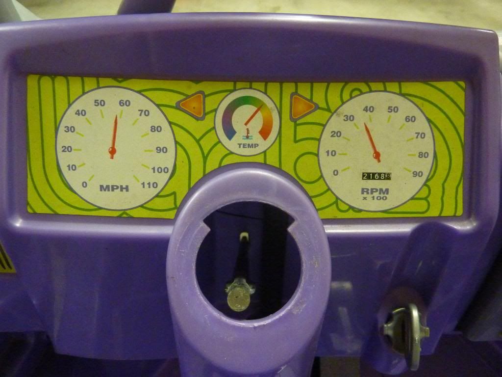

I didn't cycle the shifter during the initial inspection. Once I got it home and started digging in to it more, I noticed that there was no HIGH. I remember reading about a "Low Lock Out" somewhere. I pulled the screw that looked like it would inhibit motion, and voila! I guess that is why the tires are in such great condition.
Here is the dash to show what is missing. Maybe it is the same thing that goes in the exterior cradle?
