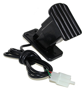

"Hall Effect Foot Pedal Throttle
For Chinese-made electric scooters, bicycles, pocket bikes, mini choppers and go karts. Wire colors: Red, Black, and Green. 49" long control cable with connector at end. "
$23.95
that would work with a power wheel?
And to make sure I understand, a "hall effect" throttle is basically like a go-cart's or car's gas pedal where speed will increase as you push down harder instead of the basic complete on / off and wheels stopped that is standard in a power wheel?
$23.95
Yes thats how they work,but you must use them with a scooter controller.
Wiring them directly to a PW harness will burn them up almost instantly because of the amount of amps these little motors draw.
$23.95
Sort of. The pedal by itself is useless. It's designed to work with a scooter controller that actually handles the power to the motors. It's no different than a twist throttle. It's basically a different kind of potentiometer that sends the throttle signal to the controller.

Posted - 09/22/2010 :  16:06:40  Show Profile
I think we're getting lost in the terminology
in a line is this possible
TNC "hall effect" pedal -> insert wire -> insert name of something I don't know -> insert another thing I don't know -> plugged/wired in such a way it controls the throttle of a super6 power wheel
Not sure how else to ask the question
First, yes.
The "scooter controller" is a generic name for a device that delivers a variable amount of power to the motors.
A scooter controller needs some kind of a signal to know if it's full throttle, half throttle, or none. Most scooters have a twist grip or a thumb throttle on the handlebars.
Or a foot throttle.
Only about 5 volts go through the throttle - less than 1/100 of a watt total power.
The controller takes that info and sends the right amount of power out to the motors.
(I'm over-simplifying this for the discussion - more info is here if you want to know how it all works inside the box)
