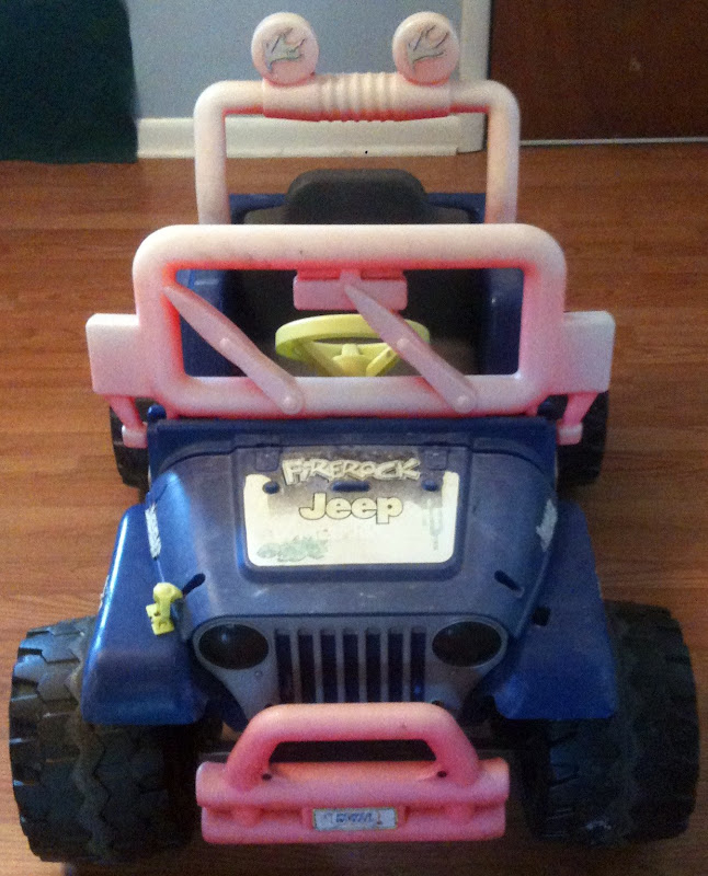

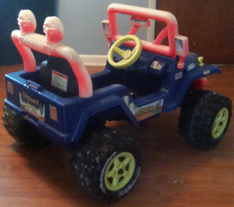

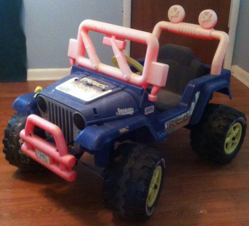

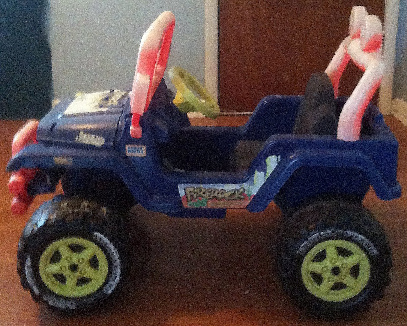

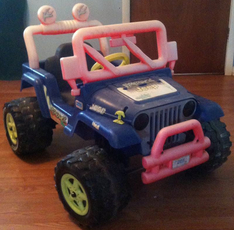

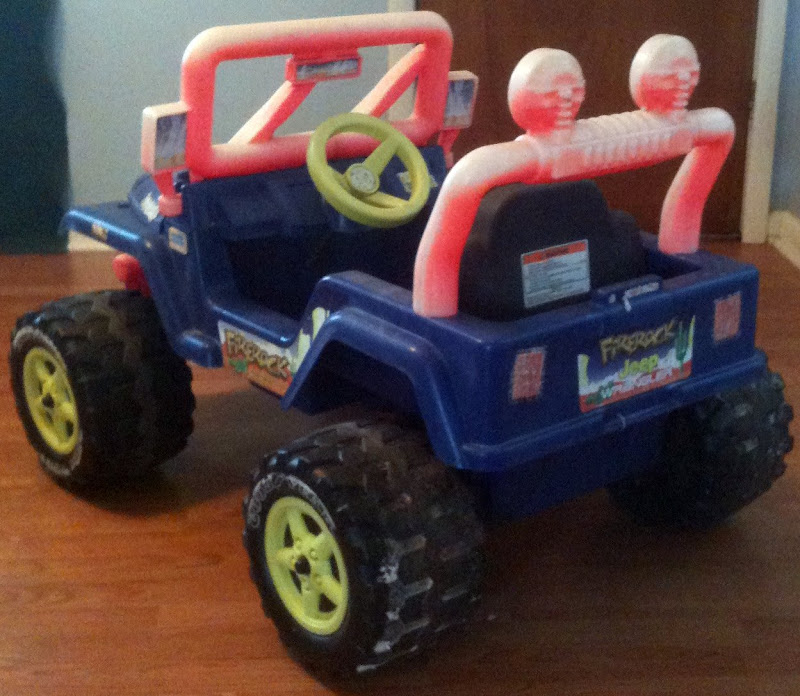

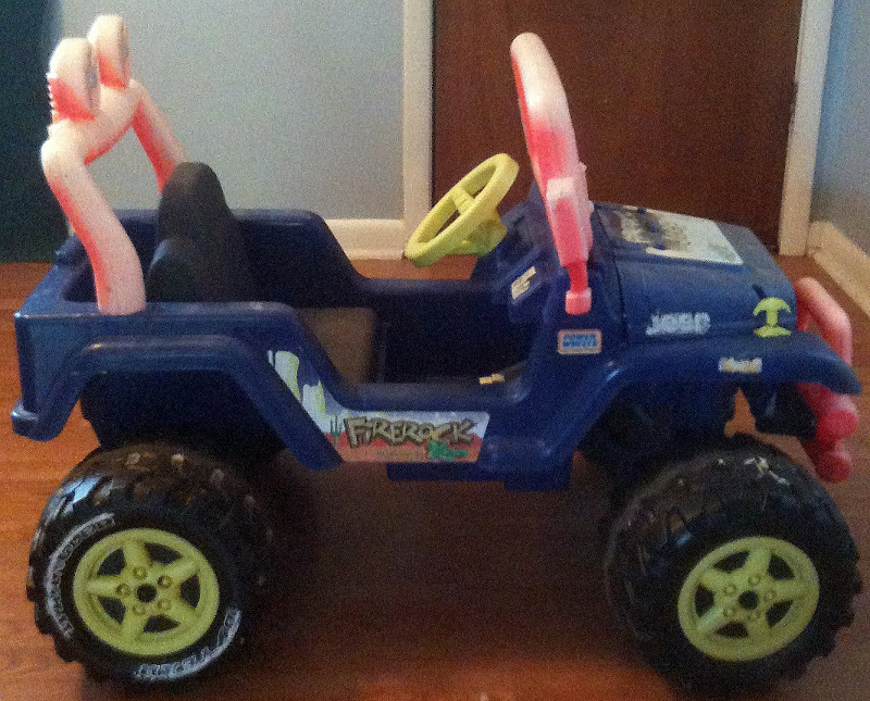

I got a Super 6 PW Firerock Jeep Wrangler for free in the last few months from Dwants2mod, an MPW member. It was only a 15 minute drive from my work to pick it up. I easily upgraded it from 6V to 12V by placing a Powertron 12V 11Ah battery in the area where the stock battery goes. It is a perfect fit. This thing moves real nice on 12V. I'll post pictures of the 12V battery installed as soon as I get a chance.

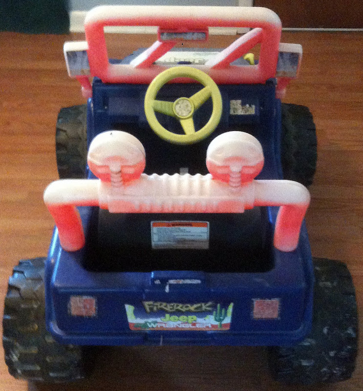

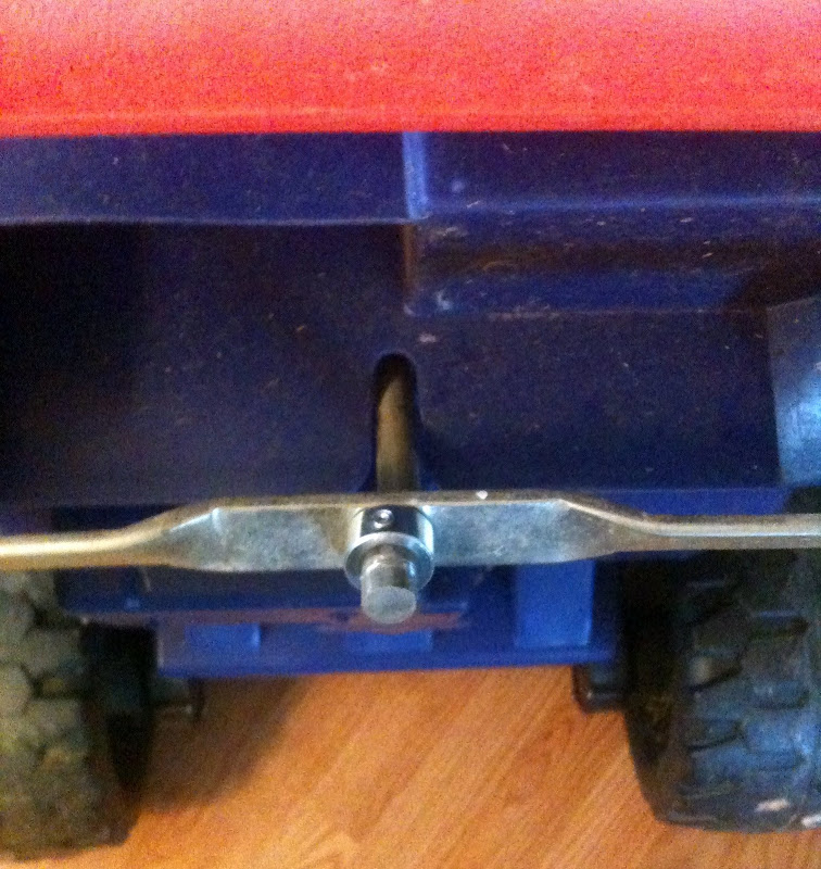

The steering wheel on this Firerock moved up and down a good bit. I removed the push nut on the bottom of the steering rod. Then I replaced it with a shaft collar (drill stop from Harbor Freight). Now the steering wheel is perfect!
