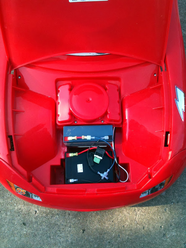

Hey, post a pict of how the batteries fit. Which ones did you order.

I used gseric69's pictures as reference.
gseric69's Lightning McQueen 18V battery setup
gseric69's Lightning McQueen engine compartment modification
I'll post pics of mine as soon as I get a chance. I made the cutout for the 6V battery just a tad too large on mine. So, I had to use some epoxy putty to rebuild about 3/16 inch around the top to hold the battery nice and snug. I hope to have time this evening to sand it down to get the 6V battery to fit again.
I purchased the 6V 12Ah and 12V 12Ah batteries from gruberpower.com.
Gruber 6V 12Ah
Gruber 12V 12Ah
Gruber sent me a Power-Sonic brand 6V and a Leoch brand 12V instead. Though, they meet the same specifications as the Gruber brand batteries.
Thanks
I finally got around to snapping a couple pics of the 18V setup in our 12V Lightning McQueen. Here they are.
You may notice around the edges of the left side where the batteries meet the plastic of the vehicle that I used epoxy putty to build up that area to provide a tighter fit. I had accidentally trimmed a little too much using my rotary tool. After I let the epoxy putty set, I painted it red using some acrylic paint from my wife's craft supplies. I think it turned out well and the epoxy putty is holding strong.
The sticky looking residue on the top of the blue battery is from some Gorilla Tape that I used to secure that battery in my son's Lil Quad.
