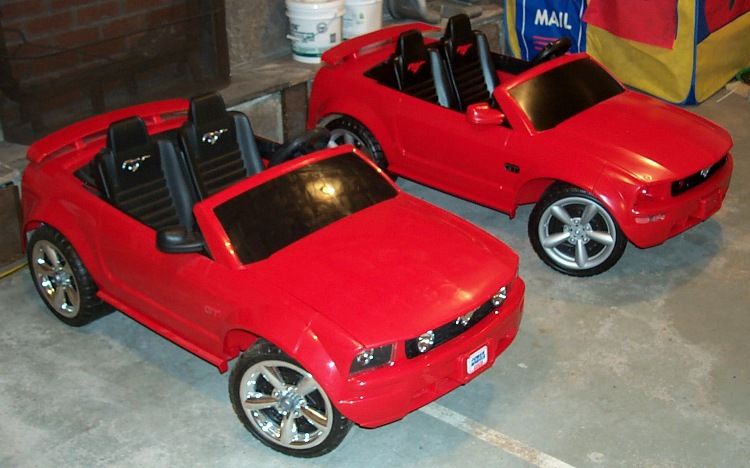

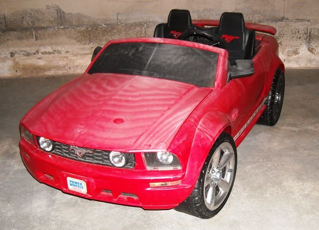

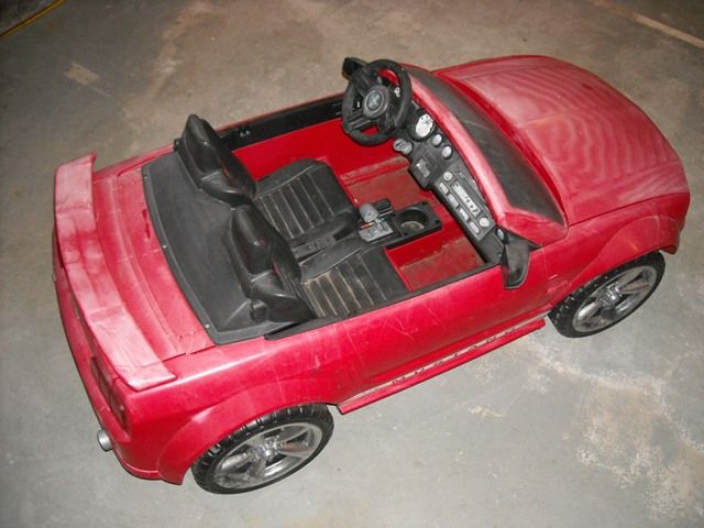

Here's the Mustang I found for $35 on Craigslist..
It obviously sat outside as it is quite faded and spider web infested
The good thing though is that the tires have zero wear, the shifter
still had the hi-speed lockout screw in place and the seat was all
the way forward so it was most likely driven by a little kid in slow speed only.
My youngest, Cooper, wants a red Mustang for Christmas very badly but there
was no way we could afford to buy him a new one.. Finding this one came at the perfect time.
My plan is to completely take it apart and clean and repaint the whole car.
It will stay bright red and the interior will get freshened up too.
I'm also going to add lighting front and rear.
It's going to take some TLC to get it ready for Christmas morning, but
I'm looking forward to working on it.. it will be SO worth the smile it brings
Kev

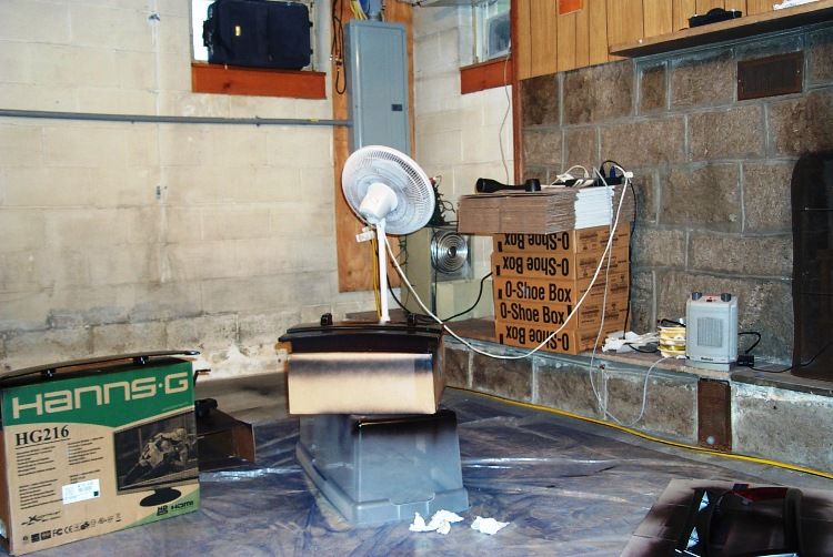

Posted - 11/27/2009 :  19:13:22  Show Profile  Visit turbokev's Homepage
"stealth mode" ... yep.. this one is getting done in the basement.
It's taken apart now for the most part.. windshield and dash are out,
trunk, hood, front clip etc.. just the wheels and motors left to remove.

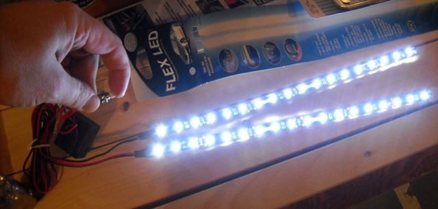

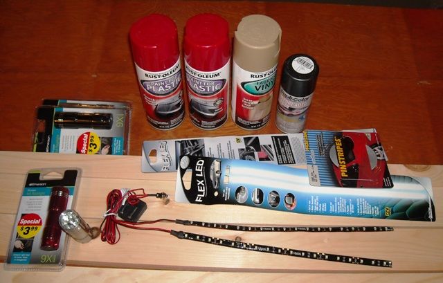

I picked up some supplies today..
Flame red plastic paint, tan interior paint, pinstripe, & LED lighting.

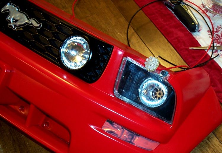

I grabbed four of the cheap LED flashlights that have 9 LEDs in a circle..
I think they are going to work perfectly for the headlights and driving lights..

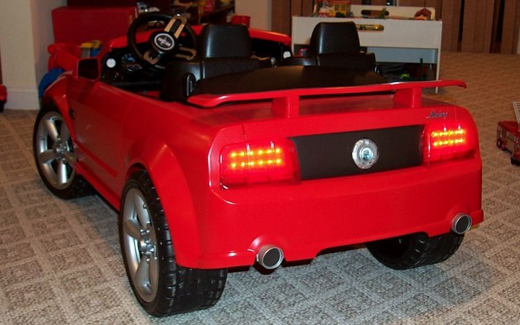

The LED strips are great.. prewired to work on 12V, and you can cut off
three at a time and run jumper wires to each little section or leave them
in a long strip.. there are 36 LEDs in total and they are pretty bright
These strips are going to be perfect for the Mustang tail lights / brake lights~

dude...homedepot had a sale of 6 flashlights plus 2 head lamps, along with 24 aaa batteries for 10 bucks.

Be sure to keep that little demo battery pack that came with the LED strips. It's very handy for testing and trouble shooting.

Yep, picked up a set myself. My initial reaction was these were much cheaper quality than the set they had for the same price last year. I just pulled them out and did a side by side comparo and, for PW light application, I think this year's are actually better. Both have 6 LEDs. This year's are grouped more tightly and they put off a whiter, tiny bit brighter light. The flashlight bodies are definitely thinner gauge metal and are lighter, making them "feel" cheaper. But, in MPW uses, most folks just want the internals anyway and the thinner bodies will be easier to cut through. :)

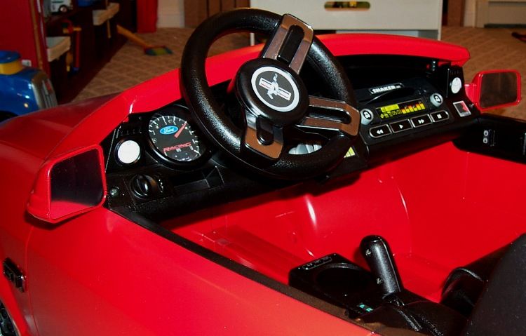

I did order a few things from Hobbymasters though..
A brand new radio/soundbox, battery meter, chrome stickers, and Barbie stickers for the Mustang.
The Barbie sheet at least has new vents, knobs, parking lights, 3rd brake light and lower grill stickers..
I'll make my own gauge stickers for the dash.
I was going to buy hubcaps but at $8 dollars each it was just a little too much..I'll paint the ones I have instead.

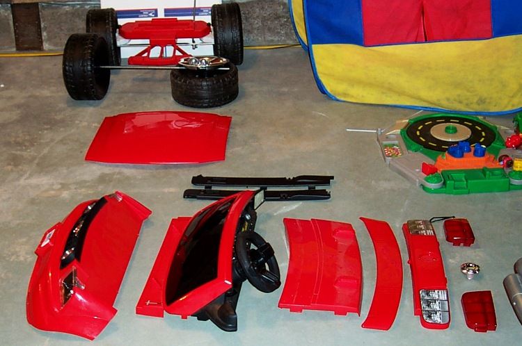

I have the car completely apart now..
Look at these tires..this is the right rear and is the 'worst' one
Aside from a couple small scratches, there is no wear..
It's amazing how dirty and faded the car is for such an obvious lack of use..
Now I'm cleaning stuff up and get ready for paint and wiring~

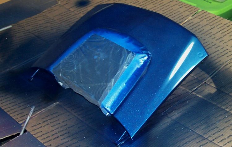

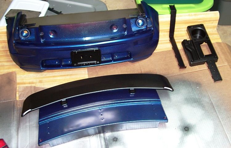

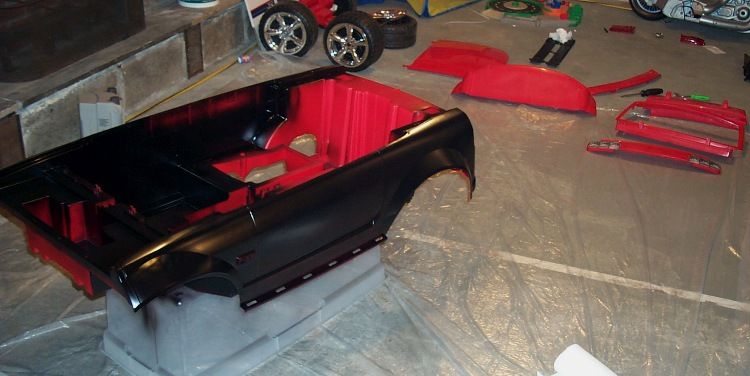

Got out to the garage at lunchtime to start the painting process..
It's in pieces and it already looks 100 times better
I also got the dash cleaned up and installed switches in the center vents..
One for the main power and one for the lights..
Tonight I'm going to detail the dash..

Put one 12V Oznium Superflux in each light up front and she'll be plenty bright!! The stock buckets do a fairly decent job of reflecting the light back out. Just drill a small hole in the center of each and wire in parallel.

Posted - 12/03/2009 :  15:42:40  Show Profile
Is that Fusion Red? It seems so much REDDER than when I tried it...
sdubb
1661 Posts
Posted - 12/03/2009 :  17:55:08  Show Profile
Its not fusion he posted a pic of the rustoleum. I was looking for something like that but no luck around here.
I just bought the fusion and its such a dark red (its called pepper red :(
"Time to take a ride on the information superhighway."

Posted - 12/03/2009 :  18:31:18  Show Profile
Where did you get those LED strips? Those could come in handy.

I was very happy when I found the Rustoleum plastic paint at AutoZone.. Same price as Fusion at WalMart.
Took a little longer to dry, but at least is is very RED
It's going to look great assembled.. the color has a bit more gloss than the Fusion as well~
EDIT: The long LED strips came from Autozone as well.. they are 12V ready.
..and, you can cut them in to little segments and solder jumpers..
They are going to be my brake and tail lights~
Kev

I got the dash painted last night and added a couple switches to the center vents for lighting.
Also got the center console painted.. Need to find a PRNDL to print up for it~

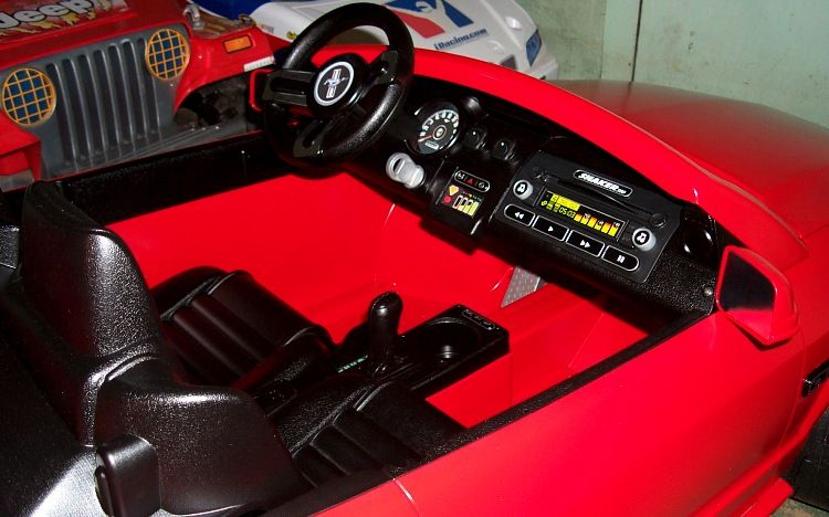

Got sidetracked today with 'around the house' projects but I did
manage to get the dash just about done..
I printed up some new gauges for the dash and used one of my wifes serious
looking hole punch contraptions to get the LEDs lined up nicely..
Also added a little detail to the center console and dash..
I also started work on the taillights by printing up new stickers for
the inside of the lens area..wasn't easy finding an image to use~

I did the tail lights tonight.. but I'll document the headlights too..
I printed up some new inner lens stickers and trimmed out the areas where the LEDs will go..
Here they are on the tail panel and ready to go back in the car..
...and here is the panel back in..

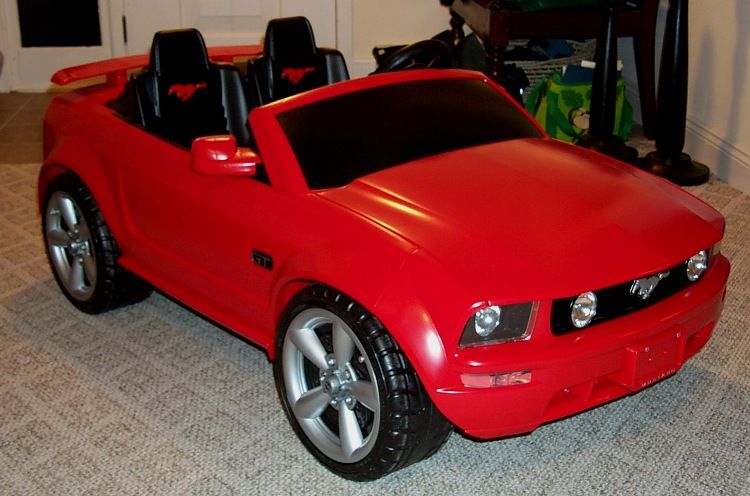

Posted - 12/14/2009 :  05:11:00  Show Profile  Visit turbokev's Homepage
The restoration of the red Mustang is nearly complete..
Everything is back together, I'm just waiting on an LED setup I ordered for the front lights.
Got my new radio and battery meter from Hobbymasters installed too.
The car is looking FAR better than it did 2 weeks ago!
Now for the part I wasn't really planning on.. Another Mustang came up (somewhat) locally and I had to get it.
Now both boys will have a Mustang parked next to the tree Christmas morning..
only problem is that my oldest really doesn't like red so I need to do a complete repaint
on this second one even though it is in brand new condition.. I should have time to get
this one done for Christmas moring as well..
Here it is next to the nearly completed one~

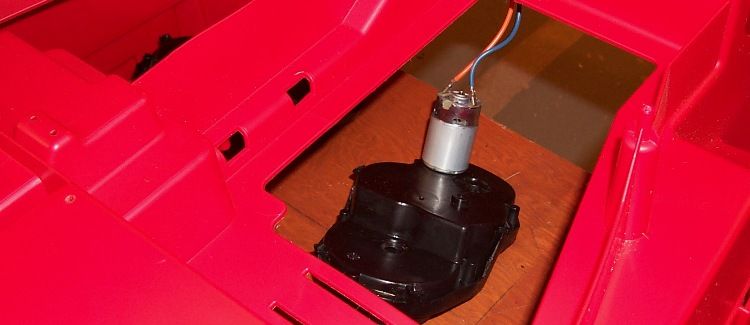

It was soooo nice to take apart this one as it was seriously like new.. Zero grunge.
It only took about 20 minutes to get it apart and ready for paint prep~
look how clean the underside / motors are..
It's going to be a busy week

turbokev
Fremont
New Hampshire
1283 Posts
Posted - 12/15/2009 :  12:30:14  Show Profile  Visit turbokev's Homepage

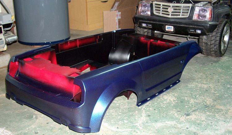

I set up my paint area in the basement last night and got the car primed..
Check out this paint booth.. especially the redneck ventilation system
(yes that's one fan pointing air at another fan -and there' an open window behind me too)
It actually works pretty well.. Priming last night and painting quite a bit today and there
have been no fumes in the living room above this area.. My wife said she can't smell a thing upstairs.
I read on the Fusion paint can a warning about applying second coats.. It says 30 minute dry
time, then apply second coats BEFORE 24 hours or AFTER 7 days.
I know there have been some discussions about wrinkled paint etc and this time line seems like what
needs to be adhered to in order for the paint to stick and dry without issues.
Of course that meant that I HAD to get color on my primed parts today insteaf of Saturday like I planned~
Here are a few shots from last night and this morning~
The blue isn't showing very well in pictures, but it's really cool in person..
My LEDs came today so I'm going to work on the taillights for the blue one and get going on some front lights too..

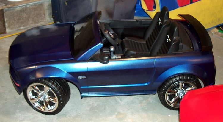

turbokev
Fremont
New Hampshire
1283 Posts

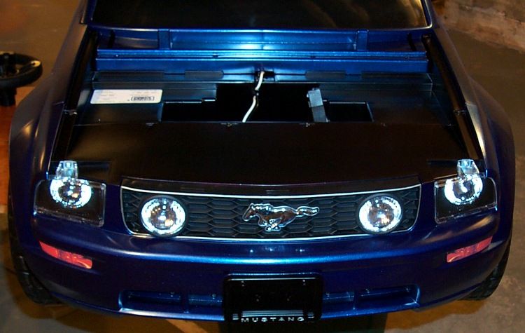

Posted - 12/21/2009 :  13:46:20  Show Profile  Visit turbokev's Homepage

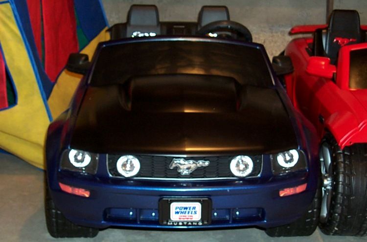

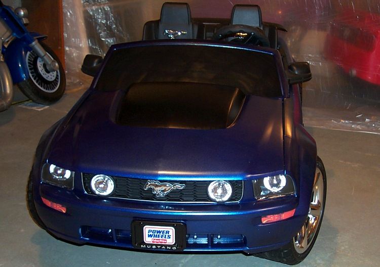

Last update before the 'completed' post.. hopefully Wednesday night~
Blue car is 99% done.. no lights, but a complete repaint with several home made stickers.
I've got a 2010 power bulge hood on the way but it took longer to get than I thought
so I painted the stock hood just to be on the safe side.. I can add the 2010 hood later.
..and the red car is 95% done.. I got the LED lights in place in the headlight reflectors..
Tomorrow I just need to connect all the wires that are already run under the hood.
Tonight I'm driving to Sayville NY to pick up our Grandmother and I'm driving her back tomorrow morning..
Leaves me just Wednesday night to finish it up since we celebrate Christmas with family
on Christmas eve.. It's going to be a busy night Wednesday LOL~

With the exception of 1 or 2 tiny details (like a front plate for the red one) they are DONE
Coopers (red)
Carters (blue)
Got the power bulge hood today so I primed it..
Then I taped off the bulge and painted it..
And put it on the car..
No lights on Carters.. just not enough time and I've already promised him we'd
do up his police Gaucho over the winter with lights and all that.. One of
his Christmas gifts will be a box full of LED strips and a strobe controller~
I'll add a couple more pictures once they are parked together by the tree..
I should have a couple of pretty excited boys on Friday
Kev

Very Very Shiny. Nice job kev

Wow, no playing around here! TKO
The Hood really sets it off.

Gorgeous, simply gorgeous paint jobs!

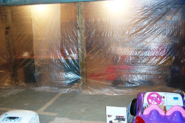

I wanna have Christmas at Turbokev's house!
I bet you'll keep the "paint booth" in the basement
