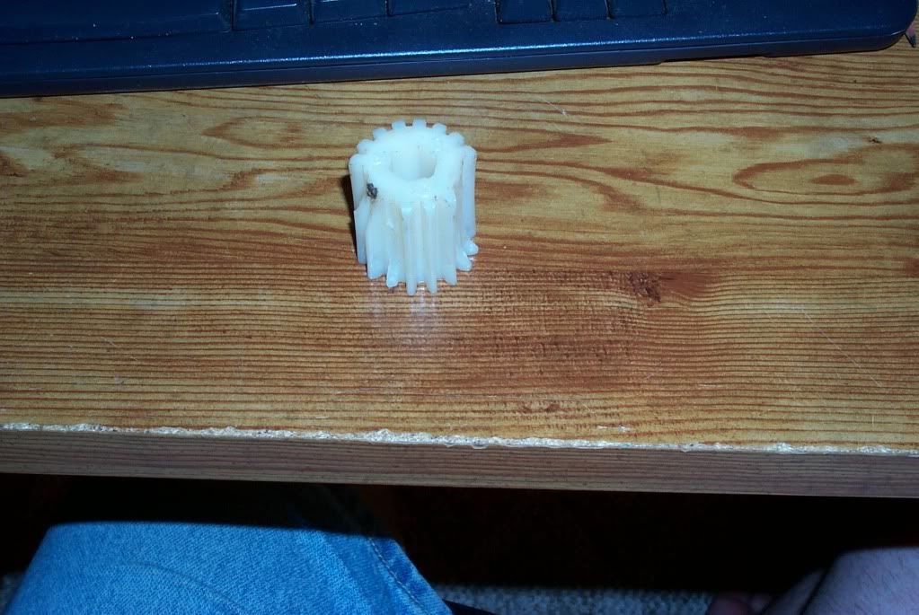

When you go to get it, check the steering carefully.
Turn the wheel back and forth and if it pops and seems to skip, or if the steering wheel is not 'centered' when the wheels are straight, look for this gear at the bottom of the shaft:
Mine was chewed up and made driving the car near impossible..
Not easy to find a replacement unless you find a second parts car like I did.
I wouldn't shy away from buying a Dale Sr. car just because the gear is bad mind you, but maybe you can get it for $10

Turbokev I checked the steering gear and it looks good and the steering is good- so thanks for the info on that!
