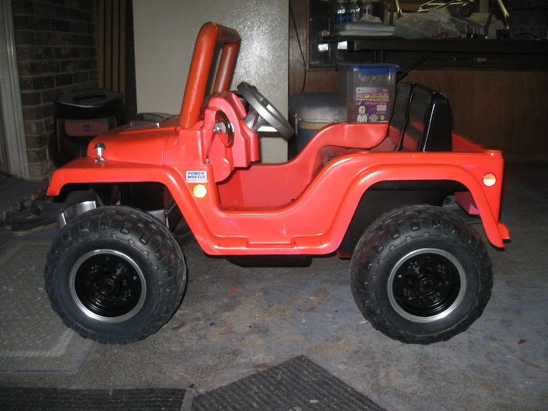

I've been working on this Jeep off and on for a while now. I will say this - I WILL NEVER RESTORE A HEAVILY SUN DAMAGED PW AGAIN!! Man, I have put a TON of work on the body and I still think it will come out just okay.
I had a hard time sanding the super chalky body, so from advice here, I power washed it. Well, that basically made it look like a moonscape. I thought about leaving it and going for the truck bedliner look, but decided to try sanding it. I started with 60 grit and that did a great job of evening it out. However, because there was so much plastic taken off from power washing, all the areas where stickers were are now raised. I did my best to sand it smooth, working from 60 all the way to 800 in increments of 60, 120, 220, 400, 600, 800. After the first spray of color, I can still see sanding marks, so I am going to try and wet sand it a bit. Here are some pictures, including my makeshift shop/paint booth.

So I was low on paint and I stopped by the store at lunch and bought a can. The Fusion cans have different caps now and the red seemed different - at least the cap colors were not the exact same. I did a test spot using an old can I had and they looked pretty good, so I went ahead and shot the body with the new can. We'll see what it looks like tomorrow. I just hope it matches otherwise I'll be re-shooting the rest of the body parts. Here is what the wheels will look like:
75.65 KB
I am very happy with the way they turned out. I may do something behind the caps to help bring them out more, but I am going to wait and see what they look like as is on the Jeep.

Okay here are more pics in its current state. I still need to put on the PW badges, radio sticker and red roll bar connectors.
97.79 KB
95.68 KB
66.86 KB
Accessories power compartment:
84.94 KB
That switch in the compartment is to turn the horn button on/off so I can turn it off if the kids get out of control. Yes, she knows exactly where it is and what it does, but it helps prevent temptation when the button is live.

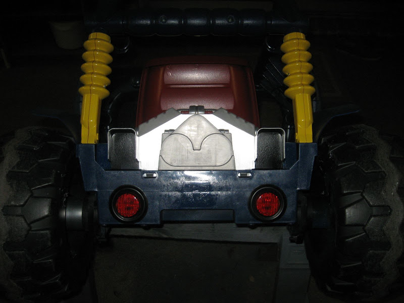

Posted - 02/27/2010 :  23:40:26  Show Profile
Got the tail-lights put in today...
Man you weren't kidding, the grommet holds them very tight! Not wired yet, they are going to be 6v running lights/12v brake lights.
Also, borrowed your rim stripe idea using chrome...
The wheels are from a raptor.
Thanks again Drew, for the ideas and the help.

i must give credit where credit is due......This topic is what made me go the route of diamond plate for my project.
She is still a work in progress but i can't wait to get her wrapped up. now i just gotta get my son walking lol

also can you give me a close view of how you are holding the wheels on, or did you just paint the caps chrome?
Travis Jennemann
Jeep Build
Tot Rod
IS LOOKING FOR A SAFETY 1ST CHOPPER
drew510
Portland
OR
1079 Posts
Posted - 04/08/2010 :  09:11:04  Show Profile
I used shaft collars from Fastenal. They look like this:
Same size as normal (7/16) but I have seen people use 1/2.
