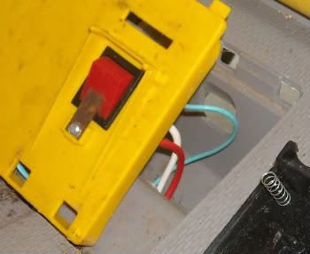

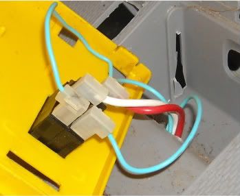

Once the parts arrived and I took the pedal assembly out I discovered the switch was not like
all the other normal pedal switches you see..
It looked like this:
Rather than play around with the Peg wiring I decided to splice in a complete PW wiring harness
and shifter that came from a free Wrangler and I knew was working well.
I did replace the shift handle itself and used an Extreme Machine part instead of the flimsy T shifter on the PW Jeep.
I had to cut some plastic for the shifter to mount and trim the rear sub assembly to fit but it went together very easily.
I also had to trim the pedal mount to fit the newer 3 prong switch.
Once everything was in place, I plugged in a PW 12V battery and the Jeep sprang to life.. all 3 speeds working perfectly.
