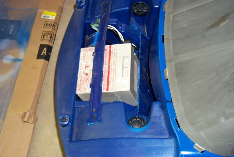

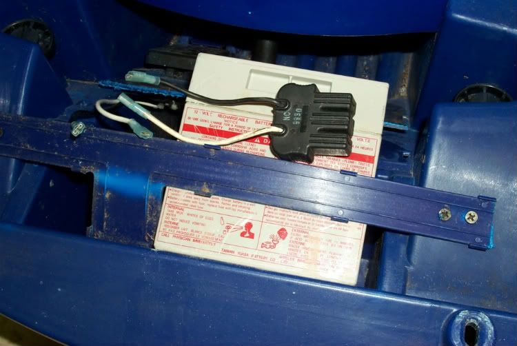

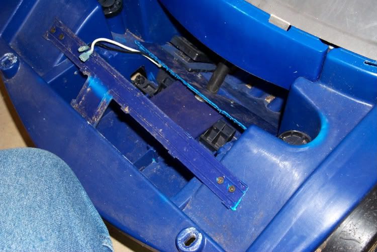

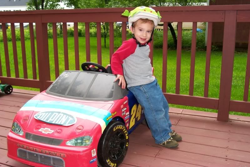

This was the second battery car we got earlier this year thanks to a find on the curb on trash day.. It's been sitting in the garage since then with both kids enjoying "pretending' to drive it.
I took it apart yesterday and got it running fine with some basic cleaning and the battery connector replaced to the newer PW style.

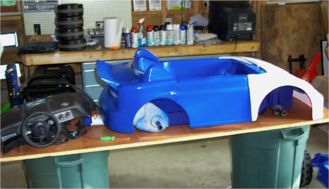

and here's the base coat of blue and white so far.. Hope to add the red and decals tomorrow.. I'd love to have it looking half way decent and drivable by Sunday so I can post it on the iRacing forums for a laugh~

Yeah I was a little surprised at the wheel / axle setup on these..
Painted some more after the kids went to bed.. Due to the weird body dimensions this will definitely be an 'interpretation' of the paint scheme.. Still need to carry the white from the hood back above the red there on the doors.. but it should be presentable when done.. (I hope lol)

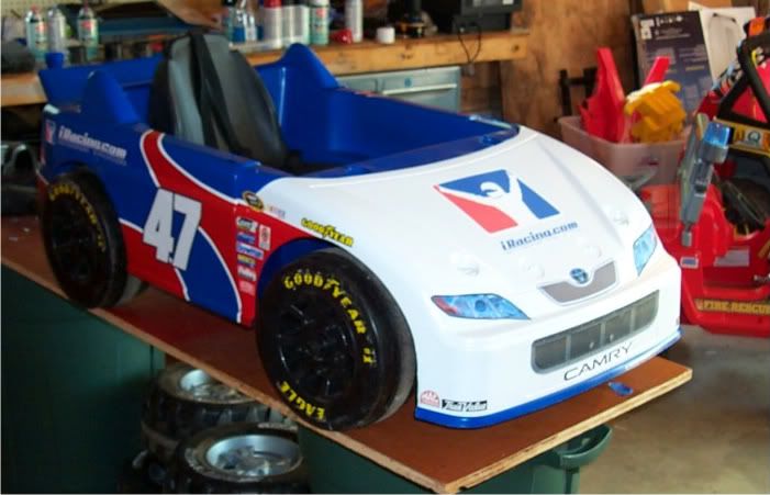

After some distraction over the last few days I finished the paint this morning and started printing some stickers tonight while I watched the truck race on TV..
Not an exact replica, but it's looking OK~

The paint and decals look great

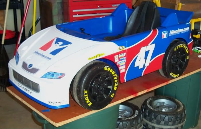

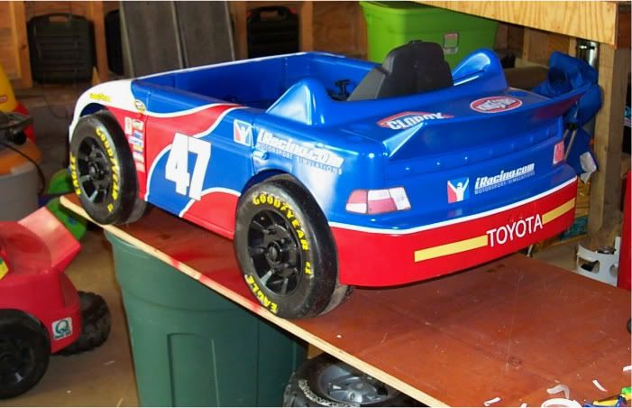

Car update..(really, I'll finish someday)

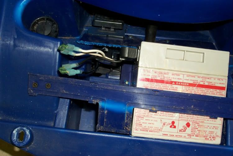

Put the electronics back together, put the seat in, and added the rest of the stickers and pinstripes.
Still need to change out the broken steering gear from the parts car I got from Adam this weekend..
I know the wheels should be silver..I'll get to them at some point too~
BTW.. The iRacing car ran in the top 7 all day at Pocono till eventual impatient winner Denny Hamlin turned David Ruetiman right into Marcus Ambrose trashing both their cars.. Nice move Denny.

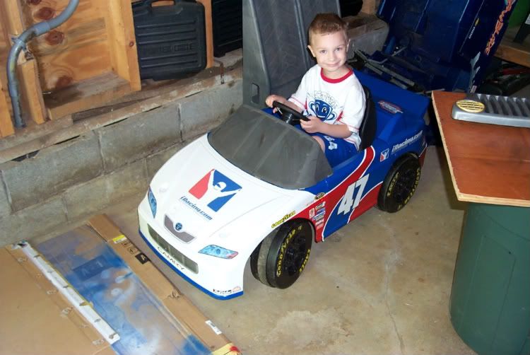

Got the car drivable tonight and gave it to Carter.. HUGE smiles.. makes every hour spent so worth it.
Still need to paint the wheels silver and bump up to 18 volts, but at least he can drive it now~
I posted this car on a sim racing forum and just got a PM from the director of competition at iRacing.. he wants me to contact him about my car..
(he said he loves it so I don't think I'm in copyright trouble LOL)

Thought I'd post the 'under the hood' shots of how I rigged the 12V PW battery to work..
WARNING.. VERY GHETTO MOD AHEAD
I cut the leads under the hood and added female spade connectors.
Also had to cut the floorboard a bit and add a plastic strap to
hold the grey style battery securely in place.
Did the same thing coming off a regular grey PW battery and plug..
Then I just connect them with mini 30 amp automotive fuses..
Here's a side shot of the battery clipped in place behind the floor
plastic and under the strap.. Stays right in place.
Car is still running and driving fine.. it's getting lots of use~
I know there are many ways to do this better, but we have 6 working cars and only 2 really good batteries (a third that's just OK) so this method of connecting them to the cars with the fuses makes it easy and adds a safegaurd at the same time. There was a heavyset 10 year old over Monday that took our Gaucho for a spin and sure enough, it popped a fuse going up a hill.. Took 10 seconds to pop in another fuse and the Jeep was back in action.
Works for me~

How does Chevrolet Feel about this mod?
Super Sweet Job!
The Paint looks perfect.
The Stickers Kick @$$!
The whole thing looks sharp!
