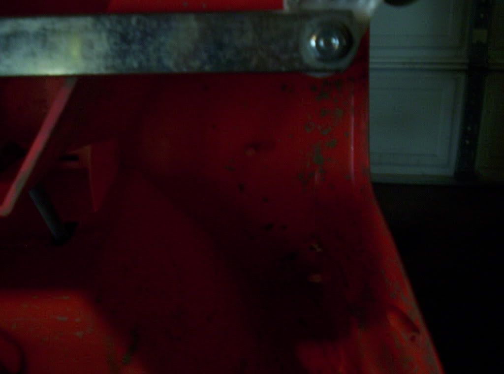

So i started putting the Jeep back together. The motor compartment under the seat was filled with leaves,pine needles, candy,toys...etc. from the original owner. I cleaned that up. Took the Gearboxes apart and greased them. Checked all the wiring and cleaned up the contacts. Here is some progress pictures. (And i added the water cannon with the hose and gun thanks to Taz!)
The nice piece of aluminum that the Jeep is resting on is what i do for a living. Replace aircraft skin.

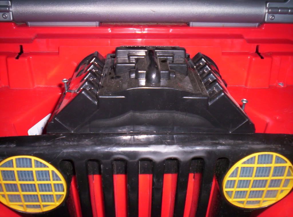

I was playing around out in the garage and put the F-150 motor in place of the hood.
that could work. hard to see from the pic, but will the hood close?

I don't have a hood yet but im sure it won't clear. I was just thinking of using it in place of the hood. Or i could have it come up through the hood. Not sure yet. I took Tazs advice and moved the battery setup to under the seat. So not sure what to do with the front end yet...

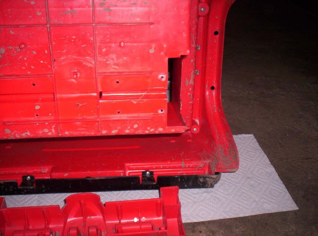

Before you add the angle, drill a 1/4 hole at the end of the crack. this should prevent further cracking. Then reinforce it.

good idea the circle will eliminate the stress at one point. Should be a pretty easy fix. I just need to have a 1/4" aluminum plate cut then just drill holes for the lift kit bolts to go through. The front will be take longer.

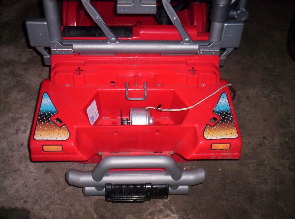

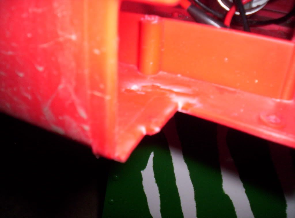

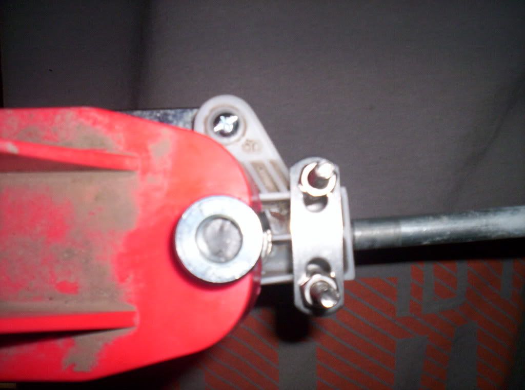

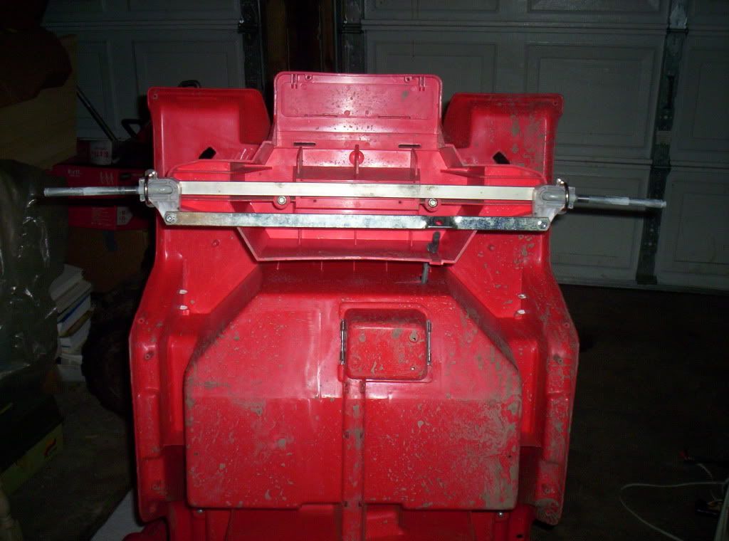

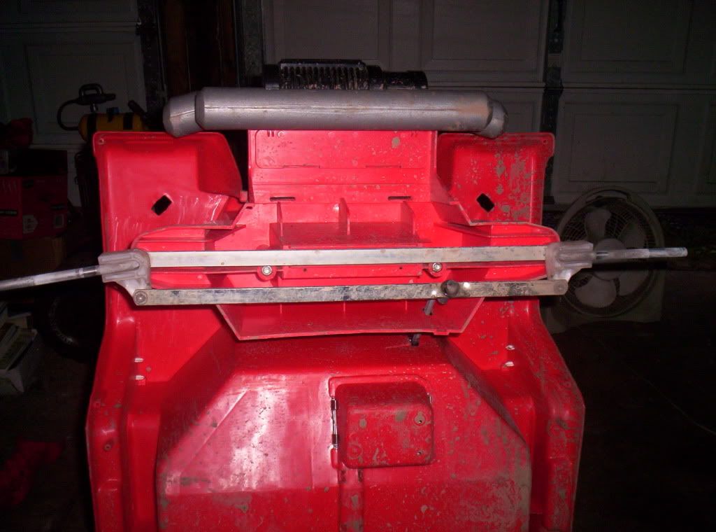

Took the Jeep all apart this week. After some heavy riding this past weekend i knew that the sag in the front tires would only get worse and the right front tire was toe-out and causing poor steering on cement. The other problem i noticed was that in the rear of the Jeep tub by the left gearbox a stress crack was starting to form from my son standing on the side when getting in. All the weight gets directed right at the corner point where the rear lift meets the tub. So i'm doing all the fixes and adding a winch to the front at my sons request.
Here some damage pictures.
I'm going to reinforce it on the bottom with aluminum angle and might drill holes and shoot heavy duty aluminum rivets.
You can see in this picture that on the right side front steering axle points the tire toe-out. The rivet is just getting loose so i'm going to take it out and replace it with a stud,washer and bolt. Going to use two aluminum plates and a U-bolt to fix the axle flexing on the white steering block.

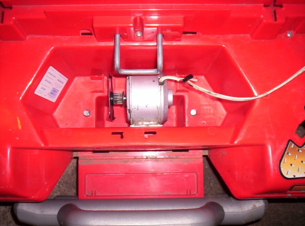

Here is the winch i made inside the hood compartment. I'm going to run it off a small 6V 4ah battery because with 12V the motor spins to fast and has to much power. I'm going to add a push button switch so the winch when work when he presses the button but will stop as soon as he lets off. Here is a pic of where i am mounting it. Its mounted in the best place for pulling power and i can run the winch line and hook out the front bumper.

I'm off to the hardware store with a list a mile long and a handful of pieces i'm bringing with me. I know once i get there i will get side tracked...end up buying stuff i really don't need and forgetting all the important parts

I'm going to put a cover over it. I'm finishing up mounting it now. Do you still have a hood/latches for the Jeep?

Posted - 08/16/2009 :  18:52:54  Show Profile  Reply with Quote
Here's some shots of the front steering assembly with the added stainless steel U-Bolts with steel plate. Replaced top axle push nuts with stainless 7/16 shaft collars and removed aluminum rivets from crossbar and replaced with new hardware that is stronger that removed all the free play the steering had..The rivets where worn out and stretched allowing the wheels to toe out. Adding the U-Bolts also eliminated all sag out of the front wheels. I will post pics when its all back together.
Below is the steering before mods. Notice how the passenger side axle sags down. The worn rivets were the main cause of this.
Here is after the mod.Much stronger and the wheels will stay straight now
This is where i replaced the aluminum rivet. Replaced with stainless sleeved bolt that fits perfect.
I have the back tires off but i threw the front wheels on and set the Jeep down and put weight on the front. The steering is stiffer and the wheels sit perfect with no more sagging. For only $22 in hardware i am happy with the results.
