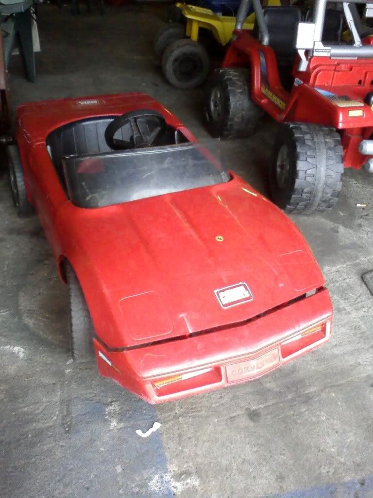

This is the start to another project. Picked up this 1988 PW Corvette at a yard sale. From what I've gathered it has the older stlye 3B GearBoxes with Super6 Motors. I just started breaking it down and only I'm trying to decided what Motor and Gearbox setup to go with. I would like to find a pair of #7 GB's to go on this for max top speed. The Corvette is so light that it will take off with that setup.Any ideas are welcome
Here's some pictures during tear down

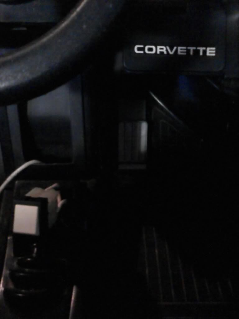

During taking it apart i just put a 6V PW battery to it and noticed sometimes when you switch the F/R Switch to reverse it does not like to go. I pulled the switch and cleaned it. Still acting up so i started bending wires with the pedal down and found a bad connection. Fixed that so far and back to tear down

I got the F/R switch rewired and finished pulling the front and rear off of the car. I Like how the corvette comes apart..The single black plastic frame is a great platform to build from. Here is some pictures with the rest off of it.

rollndice83
Lansdale
849 Posts
Posted - 07/28/2009 :  19:43:26  Show Profile  Reply with Quote
Originally posted by raymond
have the same one and they go pretty fast on 12v my daughter has a hard time controlling it on pavement and has already put deep scatches in it and have to repaint
Insert Image:
That is cool. Did you paint the interior red or is that stock? I know with 12v those tires have a hard time connecting...So i might make it a slick track car. Next to my alley is a smooth parking lot that it great when its wet

Daddyfixit- Looks good man! You can definitely see the difference. That's why I only use 3M products on anything. I know they are pricey but believe it's worth it. Can't wait to see your final results.
Treebeme- LOL. I bet my kid could..He is still low enough to the car
Now i just have to decide whether or not to take the old ceramic brake resistor off of the wiring harness. Should make the car better on the slick track but might help to smoke the motors quicker too.

Got first run video's of the 1988 Super 6Volt Corvette with 12V Modification.

He really gave the body panels a workout this morning
Not too bad for a 12V

Cool. Get some bmx rubber around the front tires. You will be amazed at how much better it turns.

Yea that is the first thing i'm going to do. And add a shoulder harness to the Rescue Jeep.

I have a few rolls of white and black vinyl so i put some racing stripes on the Corvette quick tonight to see how it would look. I like it enough to keep it on for now.

Posted - 09/12/2009 :  08:50:24  Show Profile  Visit gseric69's Homepage  Reply with Quote
Looks good!

Posted - 09/14/2009 :  13:45:23  Show Profile  Reply with Quote
Those racing stripes make a huge difference. Really nice. I never thought about using rubbing compound on the plastic but now I know what I'm doing this weekend.

Oh Yea works great. As long as the plastic is just faded and not porous or chalky. And it's easier than polishing a full size car
Side note- Thanks about the stripes. I like the hood a lot but i pulled the back stripes off. I am going to run new stripes down the back that wrap around the sticker instead of stopping at it.
