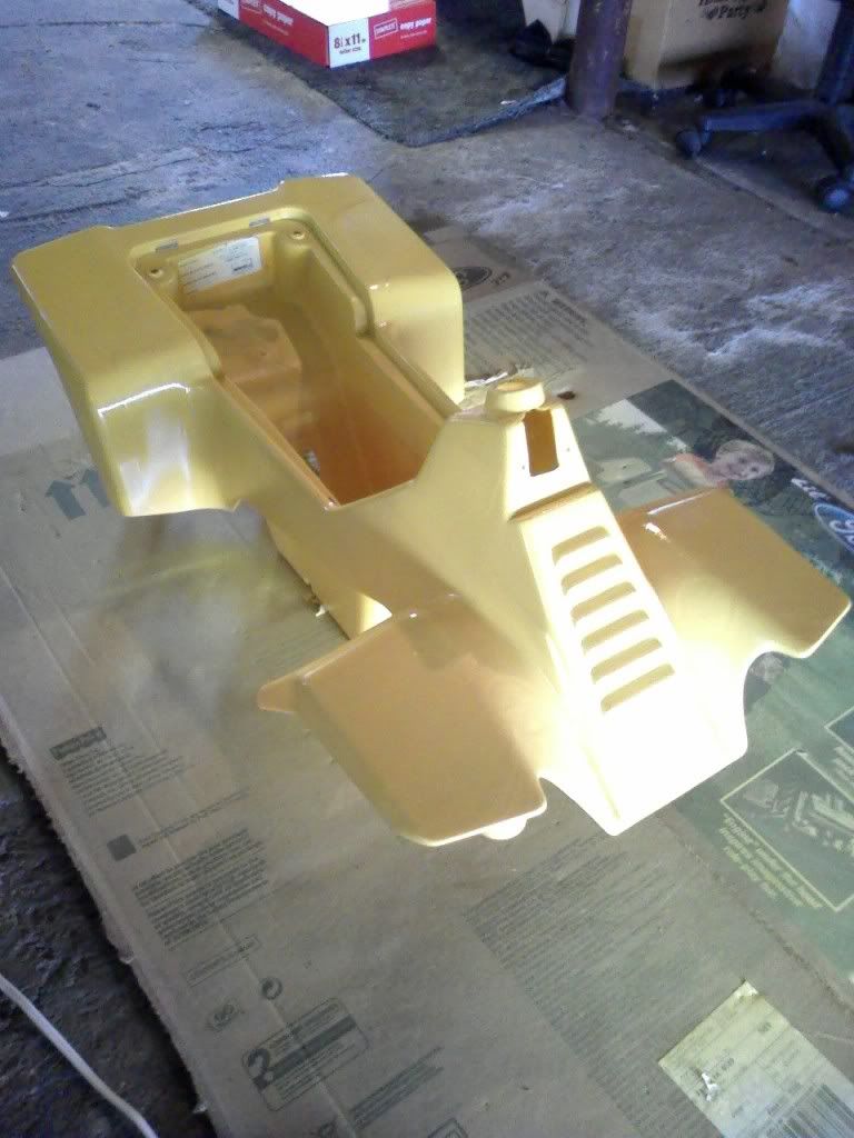

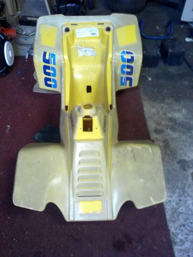

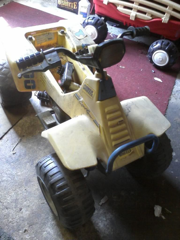

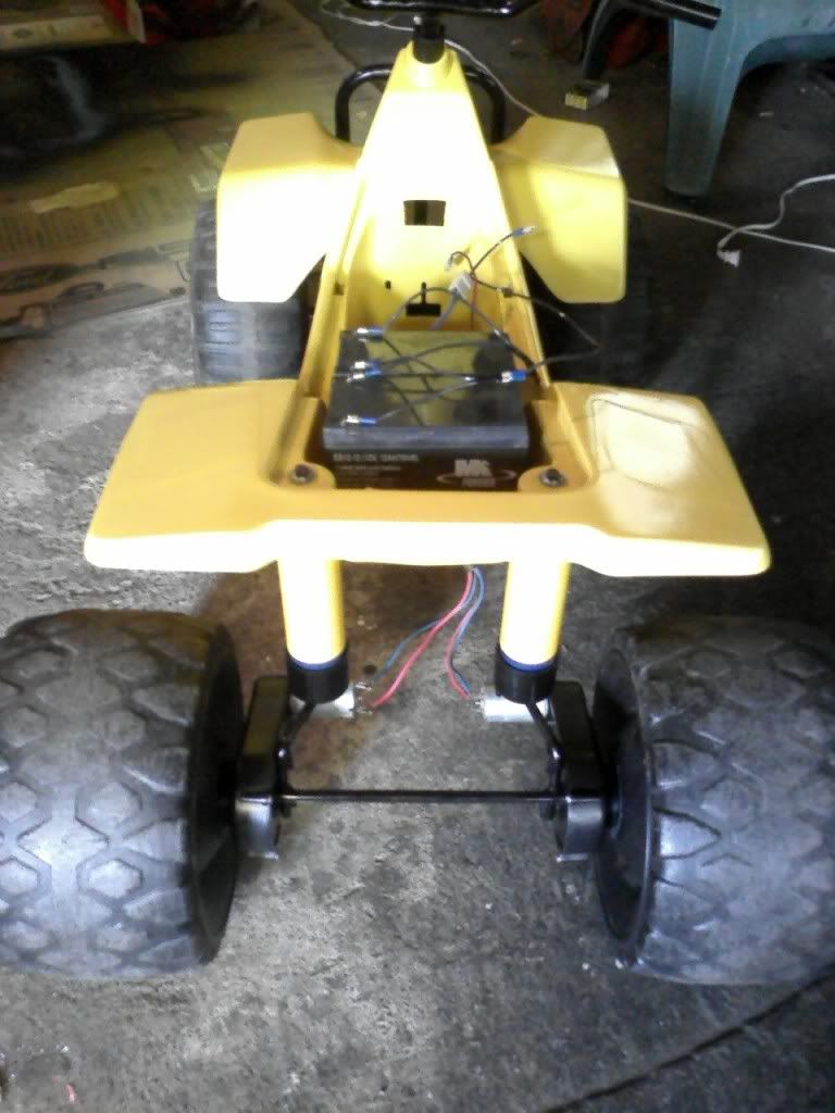

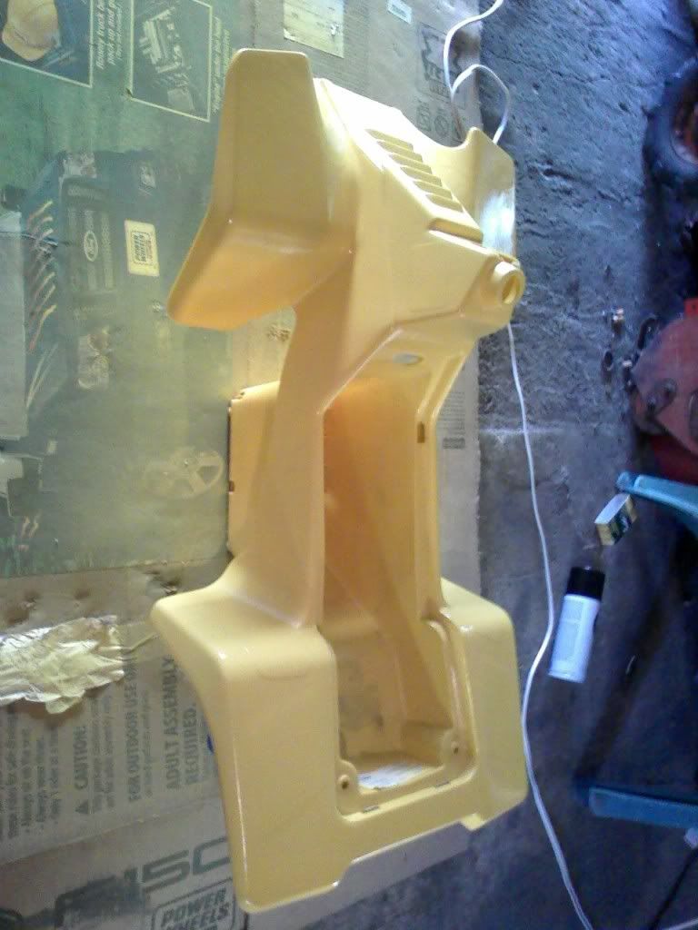

This is my second Powerwheels Mod Project. I had this 1990 Suzuki Quad Runner sitting in my garage for 2 years and decided 2 weeks ago to strip it down and rebuild it for my 4yr old son.
This is the quad original.

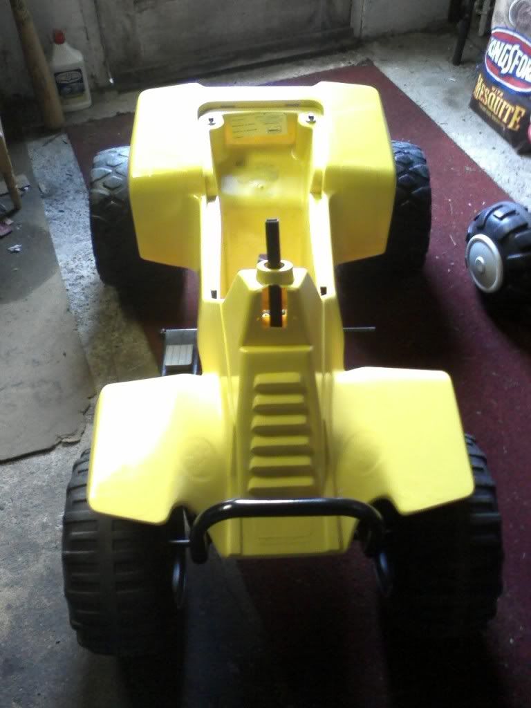

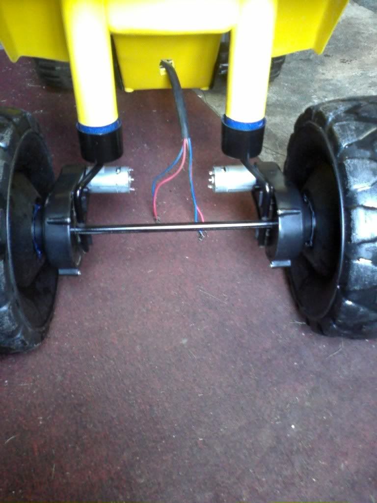

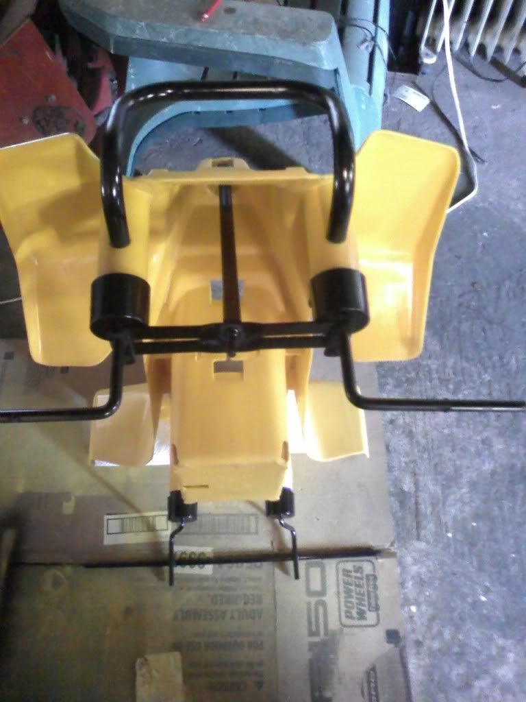

I Stripped all the parts off. Refinished all the metal and the main wiring harness.I Gave it some new paint. Added 2 Super6 Motors to the rebuilt gear boxes and added 2 12v 12ah Batteries from a electric scooter. The quad now has some great speed with decent looks to go along with it.
Below are pictures from start to finish
IT TOOK 2 DAYS TO SAND ALL OF THE BAD PLASTIC OFF THE SUN DRIED OUT
Well that is most of it. I have to add the final touches to it. My son put 45 minutes on it this morning and its running great.

Nice work! All you did was sand, no paint? I bet your arms must be tired from all that.

Posted - 07/10/2009 :  14:01:20  Show Profile  Reply with Quote
It was a lot of sanding. I painted it with Valspar Yellow Plastic paint but my cell camera is terrible. My only problem was that it blew a 15Amp inline fuse, So i put a 25Amp in and it has been fine. 25Amp too much?
Here is two more pictures after it got some dirt on it!
(Sorry for the sideways picture. Photobucket was not letting me rotate it)

Posted - 07/11/2009 :  14:35:51  Show Profile  Reply with Quote
Thanks..Its good to know I'm not the only one around here. Even know my neighbors think I'm crazy
The metal was rusted real bad so I wire wheeled it then sprayed the black paint on it.
